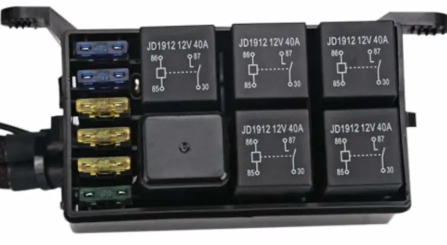

Well that is a good question. I really am not too sure how the accessory panel works. It may energize something.... Here is the "box"
1587606222589
I didn't notice this when I had it hooked to the talons factory battery so that is where I am sort of lost. Not sure what could be causing this?
Was there any sort of wiring diagram that came with it?
The isolator shouldn't cause an issue, it only decides where to send the power from the charging system.....checks main battery voltage first, then will send voltage to aux battery if the main battery voltage is OK.
On mine I used a 50a relay to power a accessory buss bar, it is triggered on by a "master switch" or as you did it by a "key on power source", this would energize the buss bar from that I pulled the power for the accessories. I would double check your wiring for the "trigger side", I'm not sure how you could have wired it up to do that but if you pulled the trigger side off the isolator that sends voltage to the aux battery it could cause it to act like you described. Do you have any pictures of your set up on the Talon?
I use that exact same box with a second battery and have no such problems. Your issue is not normal, you probably have something wired wrong. Post your wiring diagram and we can figure it out from that.

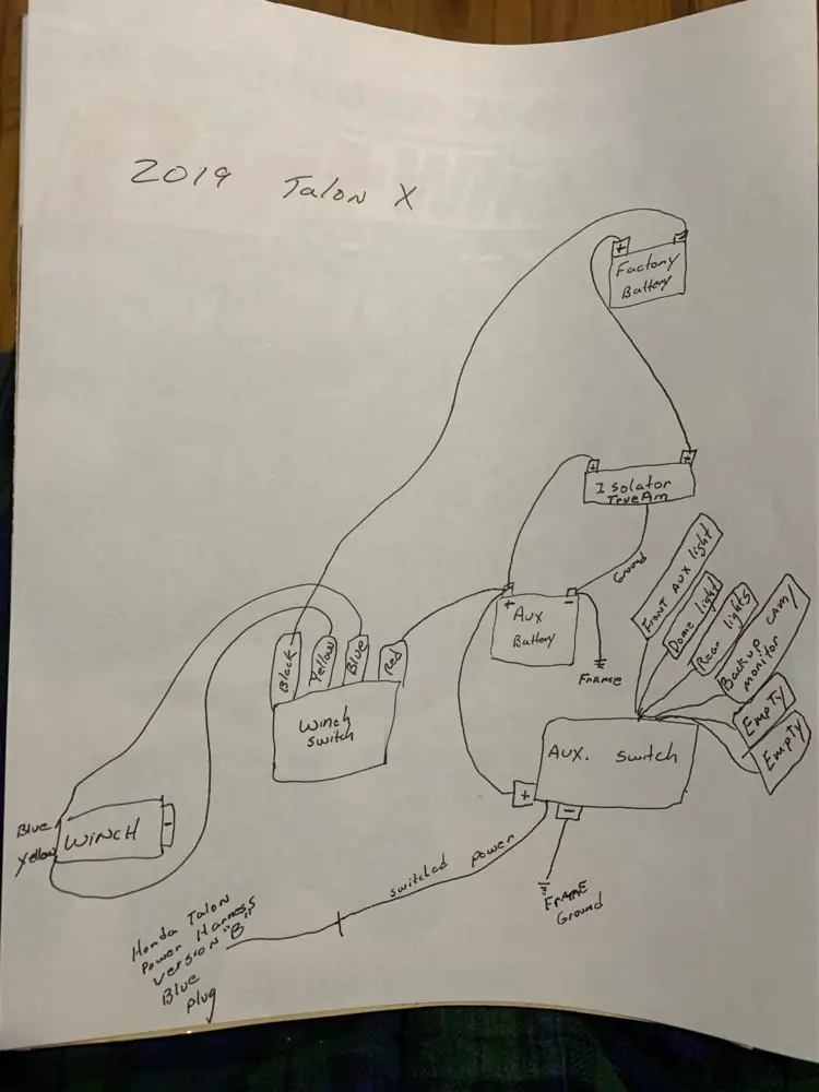

First thing - Thank you for all the feedback everyone!!
I am pulling my Keyed power from the "blue plug" from the horn (using the wiring harness from the site).
I didn't think this ever happened before I put in the second battery so i'm at a bit of a loss.
IMG 5058
906UP
906UP
Jul 6, 2017
14,405
136,869
da Yoop
You could test to see if there is a delay by running the "switched power" wire directly to the Pos "+" side of the aux battery, see if your accessories come on immediately, they should.

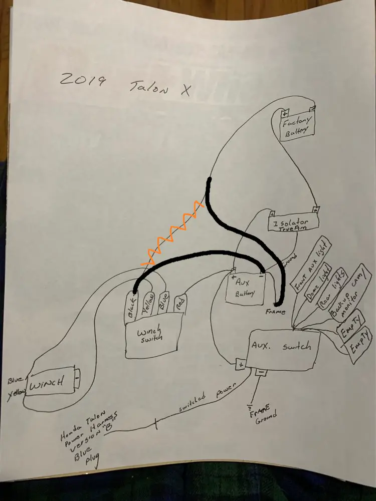

I would suggest another change unrelated to the issue you're having, concerning the negative cable for the winch. I'd recommend running a shorter cable from the winch relay to the neg side of the battery and move the "pre-run" neg from the main battery to a ground lug. The longer the cable the higher the amp loss & more heat in the cable.
YEP EXACTLY
Run your winch ground to Aux battery NEG.
Connect your Factory Battery with a 4-6 ga cable directly to the AUX battery ground.
18,510
67,230
I second this change.
Winch should be direct to the second battery both + and -.
Other than that. I see nothing else outside the fuse block operation.
I would unkook and test the key-on power wire to see if it has the delay.
Isolator is hooked up correctly according to your diagram and would not have any effect on this problem at all.

Thank you everyone - it is working correctly!
I ended up running the grounds on the batteries together and everything is working perfect! That did it everything kicks right on now and will turn on if the key is on the "on" position.
Again, thanks for the help, diagrams and message. Appreciate it.
