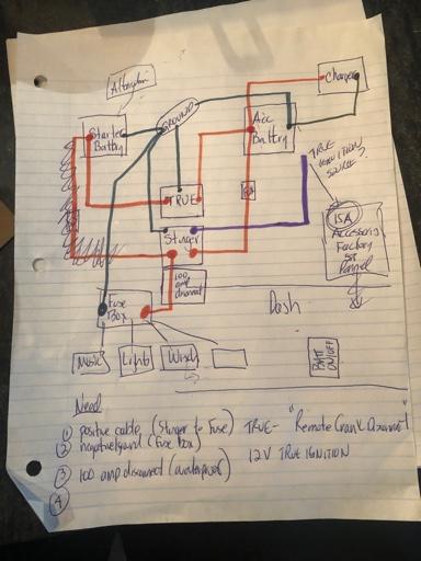

States, don’t mind my crayon drawing, but this is what I planned.... use the True isolator and a stinger. I didn’t add the stinger yet. The True is connected to both batteries. And I run a fuse box off the accessories battery. The True ensures the chassis battery is charged before charging the accessory battery. 98774eb413a94aea8e555a50da2954bd

States, don’t mind my crayon drawing, but this is what I planned.... use the True isolator and a stinger. I didn’t add the stinger yet. The True is connected to both batteries. And I run a fuse box off the accessories battery. The True ensures the chassis battery is charged before charging the accessory battery. View attachment 260137
Thanks for the sketch. Pretty close to what I figured out
