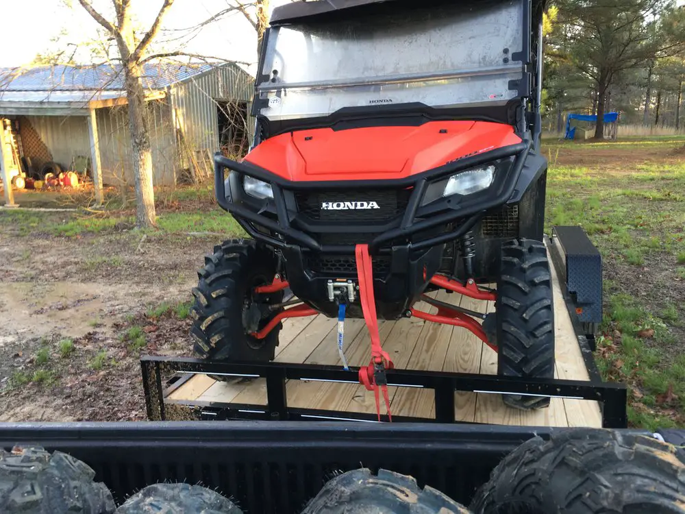

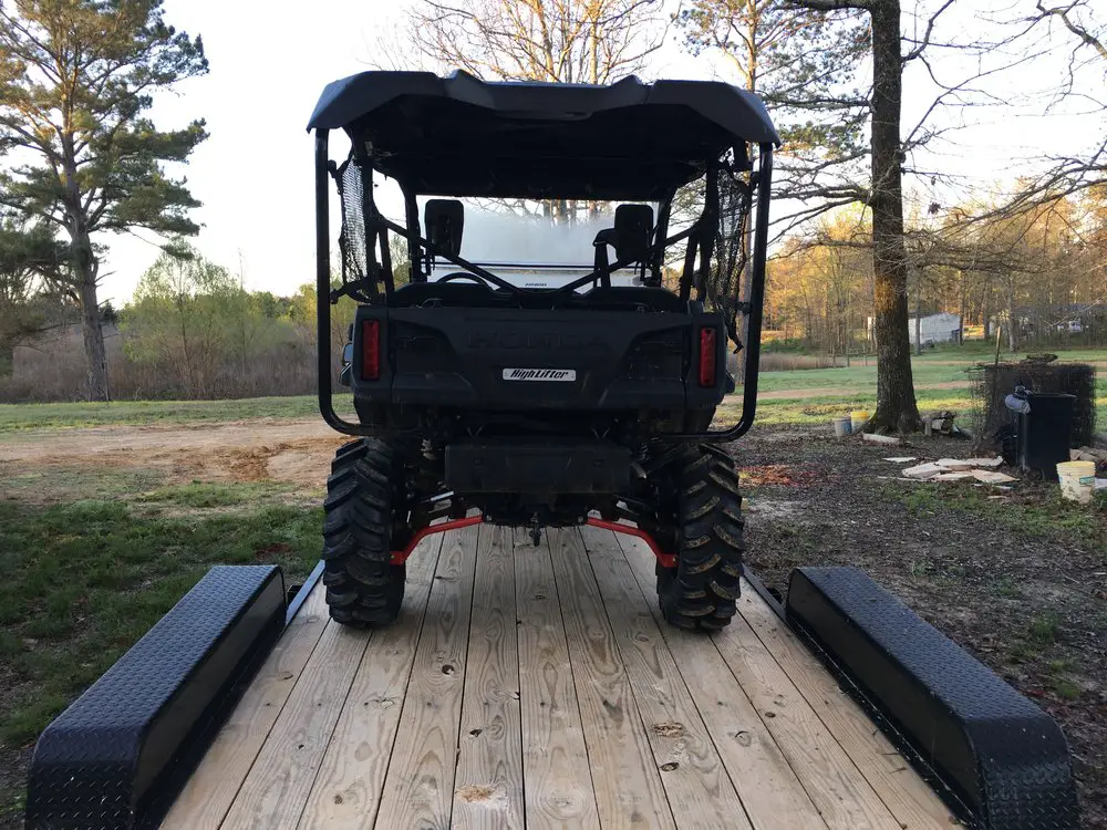

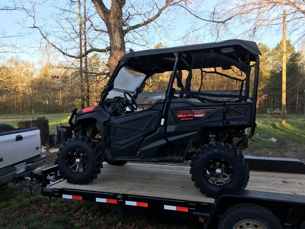

B89D10FE A578 4B85 9BD2 9C3B7FED519A A9D9E5BF B6B1 4C39 B740 BBE2184E1F9C 85D2EE09 29BE 4EEA 878B D6837FB559FA
Finished my build. Went with High Lifter clearance arms front and rear and 2.5” lift. 30x8x14 front interforce and 30x10x14 rear. Looks great and can’t wait to ride.
