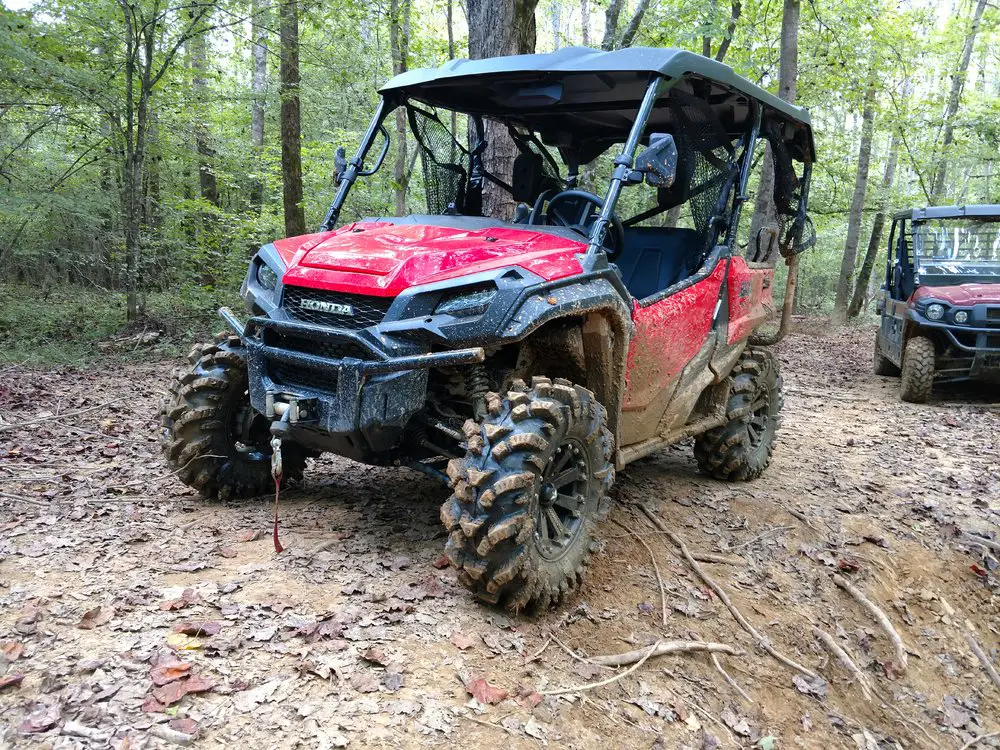

Help , Need new tires and I am not into lift but am interested in a tall tire for some extra clearance . Would like to try 30 Black Waters . Will they fit ? Or any other true 28 or taller suggestions ?

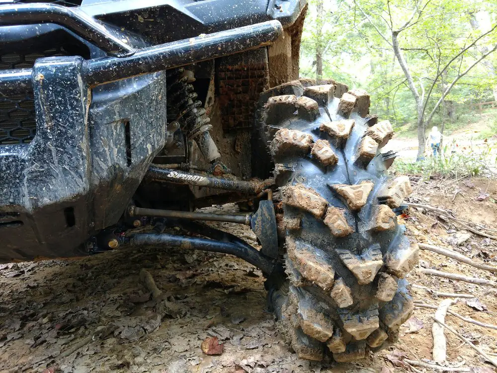

Thanks , I guess I am going to look for the tallest 28 inch tires . Any sugestions ?You could use highlighter arched a arms...they don't lift front but would allow for larger tires bc they extend out to front.
Ya I need to be sure .30" backwaters measure out to be 28.5 on the vehicle according to others on the forum

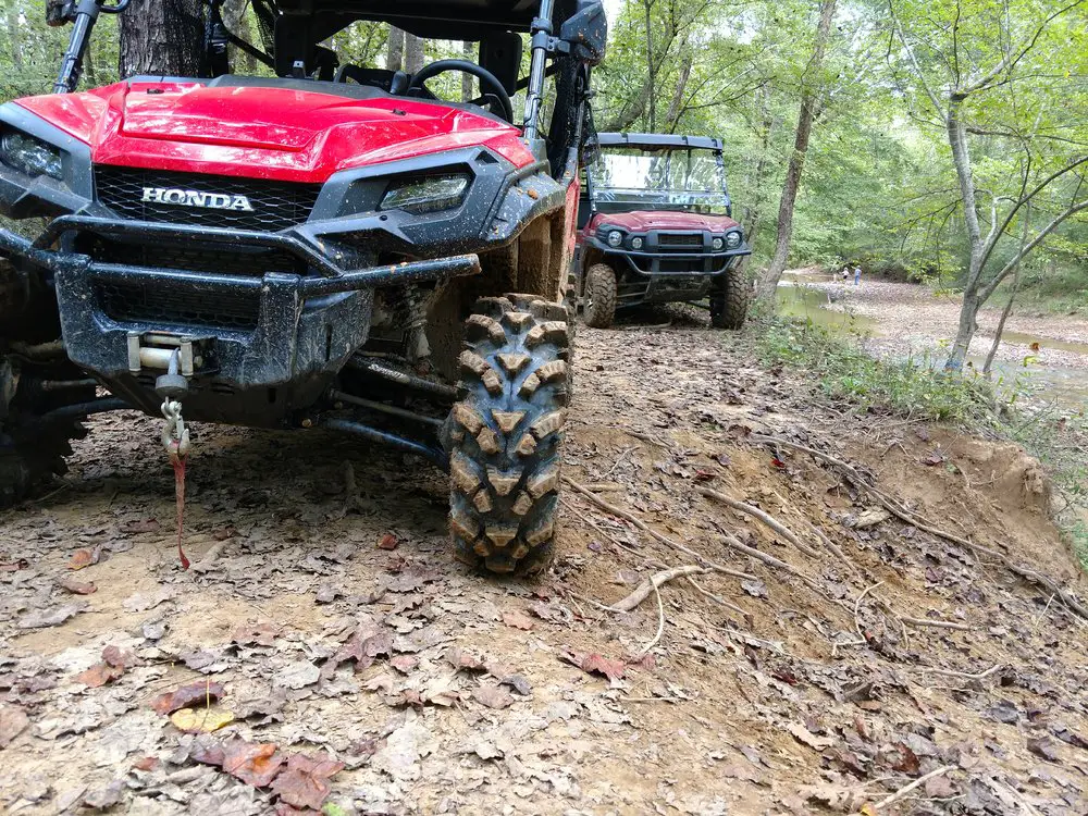

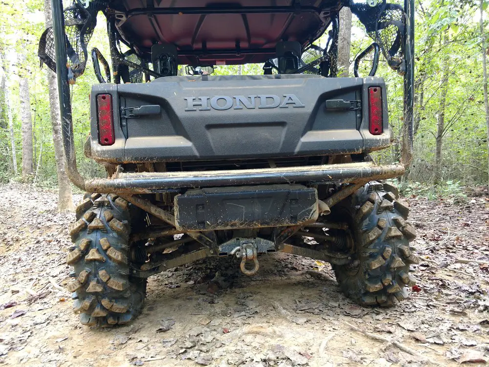

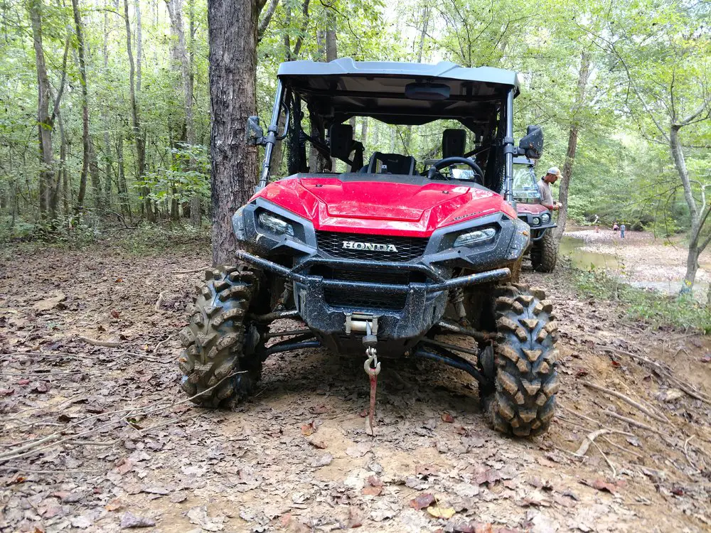

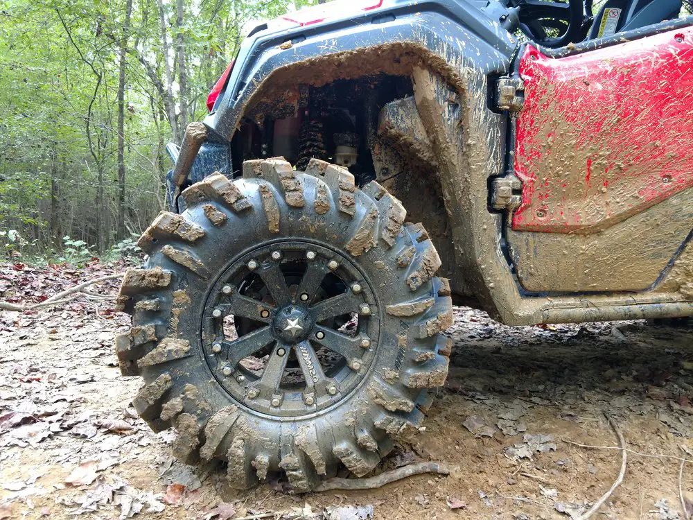

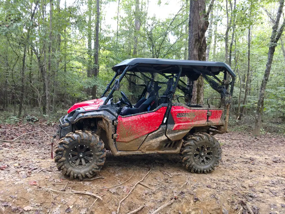

There is not a good reason to raise the center of gravity which is a result of a lift. Most of the lifts people choose are the inexpensive options which change the strut angles more vertically resulting in a harsher ride. With the SuperATV forward a-arms, 30" SuperATV Intimidator tires can be fitted without a lift. Wheels are View attachment 90460 MSA M20 Kore ATV Wheels - Flat Black [14x7] +0mm, 4/137View attachment 90460 View attachment 90461 View attachment 90462 View attachment 90463 View attachment 90464 View attachment 90465 View attachment 90466
