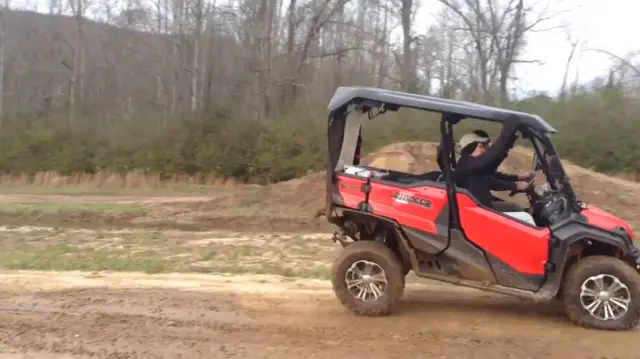

Be careful. They may make a significant impact if you ride hard. Check the pic below, this is stock 25.5" tires that are stuffed almost to the top of the fender. The roctanes I have now are a true 30" inches and there is no way they would fit even with a 2.5" high lifter kit.

My buddy is running 30" EVOs with a HL 2.5" kit and measure 28.5" and rub only a little bit.

It passes the bucket test and my lift is not a production model. It was a prototype CATVOS lift that was only 1.5" lift and 2" forward arms. The cool thing is I can pass the bucket test not only in the middle but further left and right.
