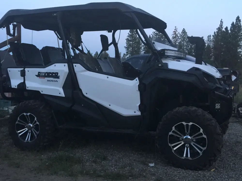

212e59d378c3c0c079cd4003d30d838f8e12f1c0cb3f17a23ece51b6baf7f6d9532c151439ddf86f8719f543290f6f65heres a few pics

There's the money shot. That looks amazing. Can you share exactly what mods had to be done to get the roof back on?

Well thank you but I was hoping onto let to many pics out till it was were it's supposed to be in the woods with the upper fixtures back on but...all 8 mounts had to be moved forward. The back one the least and the front 4 a lot. Didn't actually measure used masking tape to get placements but that's it. Was worried the backup lights mounted flush into the roof wouldn't fit but they still did. There were no problems

If only they came from the factory like this. All UTV's could use a chop on the factory cage in most cases
I totally agree!
