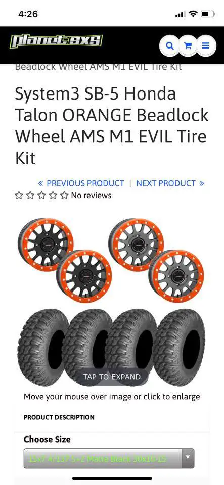

These are the ones I purchased. I appreciate the help.
