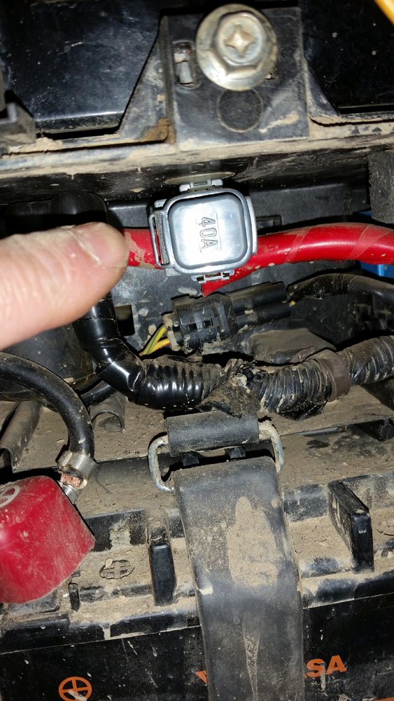

I found this fuse where my 500 sat. Not sure where its from and the new owner has not reported any issues.
IMG 20170830 185247127 IMG 20170830 185247127
C
Chooglin
I am pretty sure that is the spare , look inside the battery box , there should be a spot to store it......IIRC

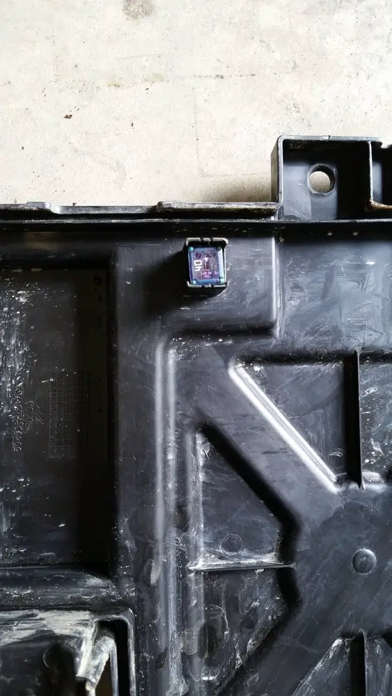

I went out in the garage and pulled my battery box lid off just to verify that I am not crazy.........lol
This is a pic of the inside of the lid where this little bugger is stored

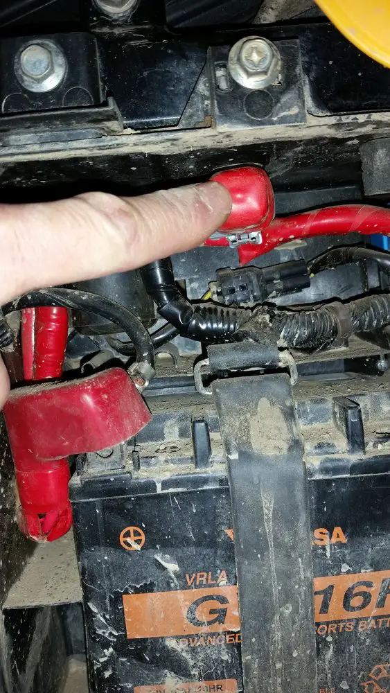

And this is the location of the 40a fuse , it's behind the little red cover.
20170831 165153
The little red cover removed
20170831 165220
Any time you remove your battery box lid , make sure the spare 40a fuse is still in storage and it didn't fall out!
