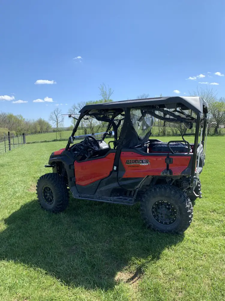

View attachment 199794You’ll be pretty wide with 4/3 offset. My guess nominally around 67”. As long as you don’t have trail width restrictions your ok. You’ll probably get a lot of mud flung in the buggy without fender flairs. I’d personally stick with 5/2 offset with the 1” spacers in the rear. It’s what most people do here it’s good results. This is what 65.5” looks like.

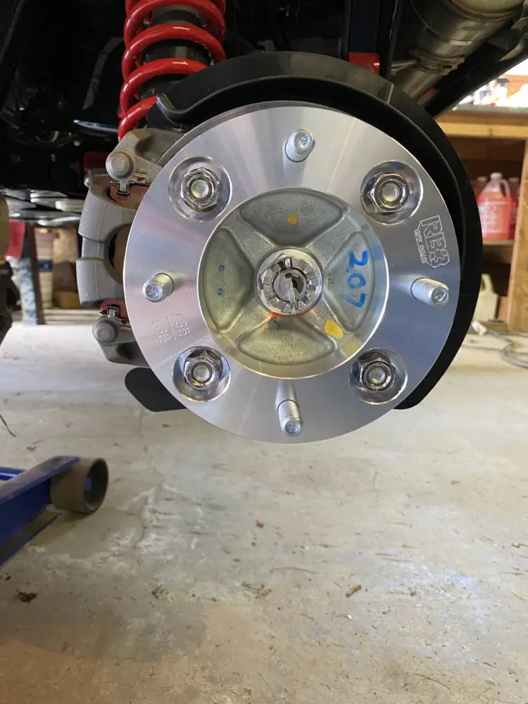

I think you’ll be fine. Supposedly you can go up to 27.5” without any rubbing on these things. My Pitbulls measure 27.25” and they are fine. I understand Terrabites run small for their listed size. I used RB3 spacers. A8783597 DC6B 4DB8 BA34 76298FAAD194

I think you’ll be fine. Supposedly you can go up to 27.5” without any rubbing on these things. My Pitbulls measure 27.25” and they are fine. I understand Terrabites run small for their listed size. I used RB3 spacers.View attachment 199867

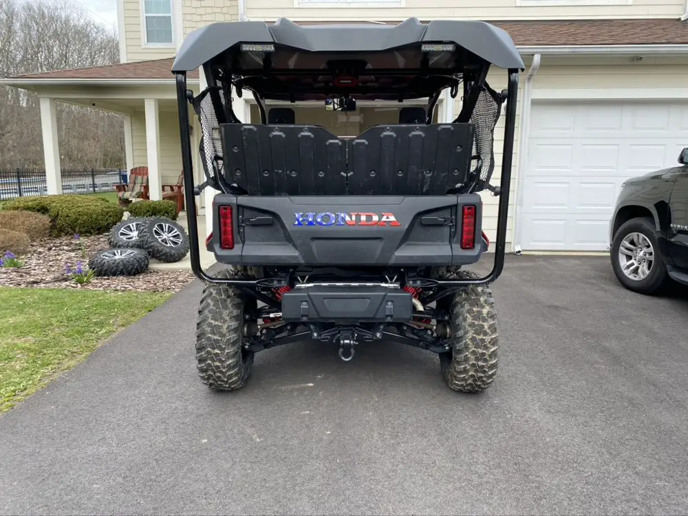

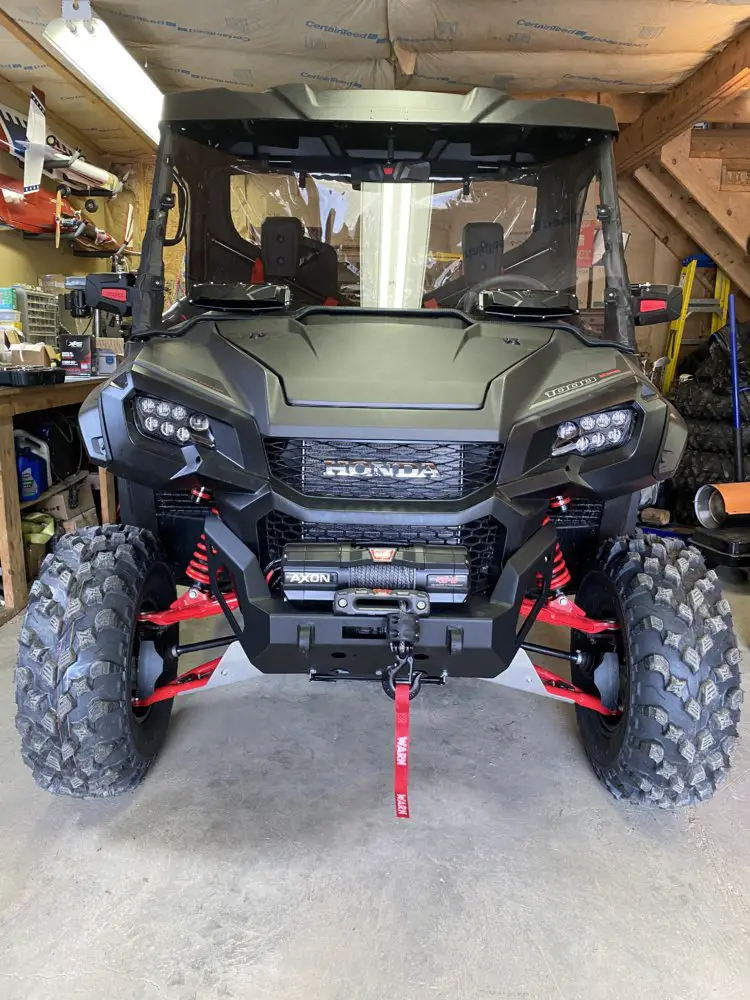

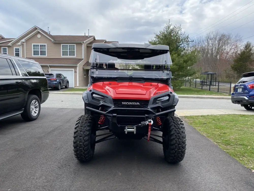

I did the exact same thing as you. Bought 5 wheel/tire in the same size to be able to have a spare. I used Tusk products from ATV Parts, ATV Tires, Dirt Bike Parts, Motocross Gear, Motorcycle parts and Motorcycle Tires | Rocky Mountain ATV/MC. Went with 28x10-14 with a 5+2 offset. They were a 4/137 bolt pattern and fit perfectly.
I measured wheel width before and after and my measurements are below. I added the Fox shocks at the same time with the preload set to factory, and gained about an inch of ground clearance all around as well. Thats without pre-loading for another 1/2" or more.
Stock:
Front wheel total width 62”
Rear wheel total width 63”
Aftermarket
Front wheel total width 63”
Rear wheel total width 64 1/2”
View attachment 199594View attachment 199596View attachment 199595

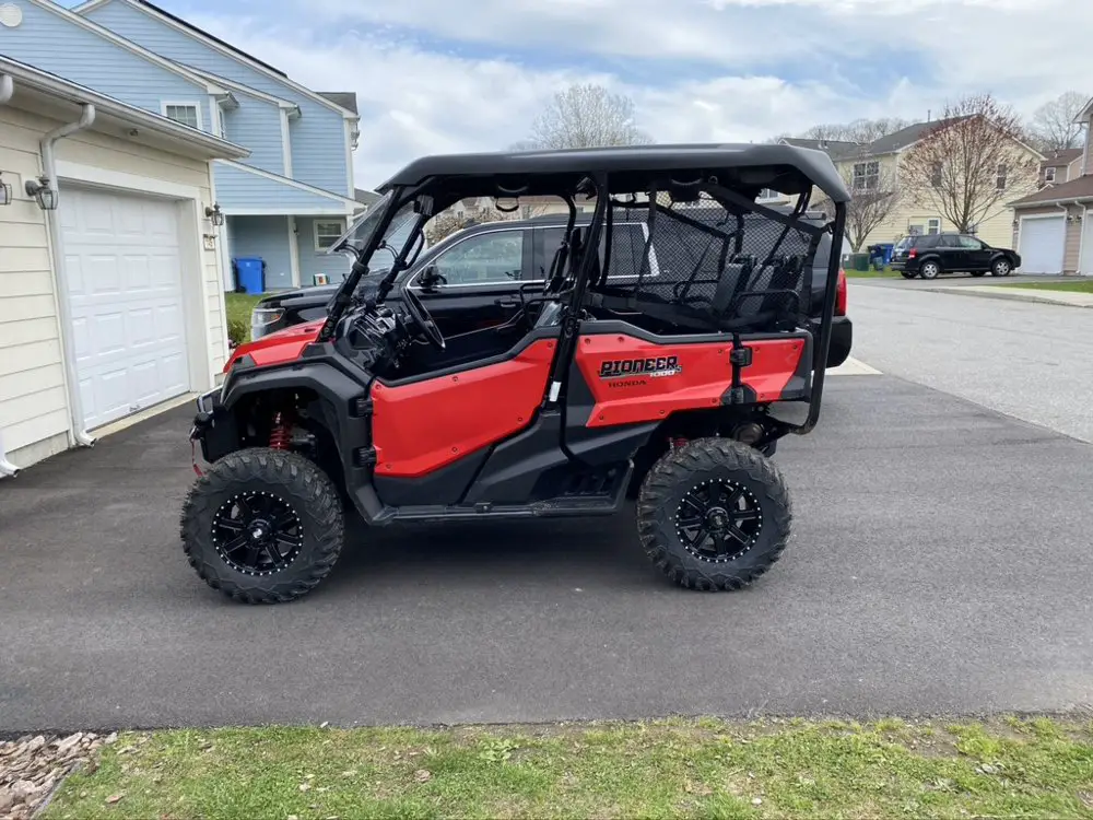

Here’s mine, 4+3 wheels with 1.5” spacers in the rear and 1” spacers up front with 30x10-14 on all four corners.
View attachment 199664View attachment 199665
Russ, your machine looks great. Few questions. I have 1" spacers all the way around and the super atv 3" lift. What wheel/tire package did you use, do you have any suspension or lift modifications? Also any clearance while turning up front with those bigger tires?
