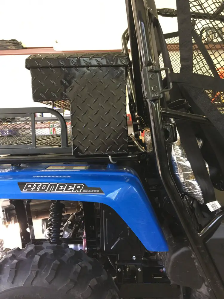

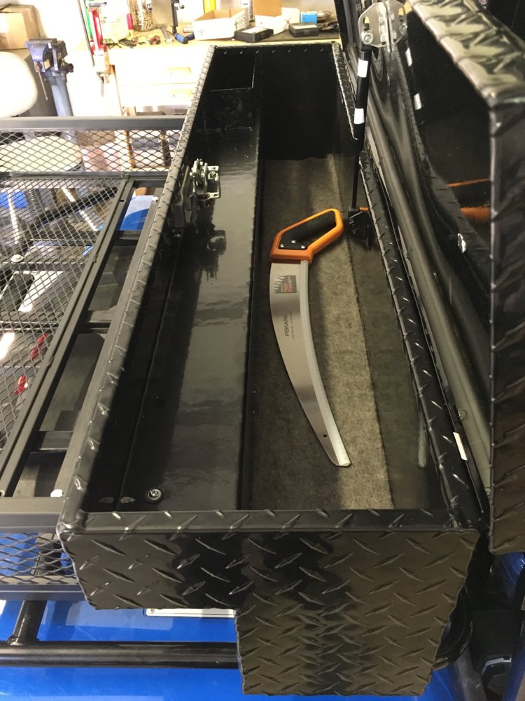

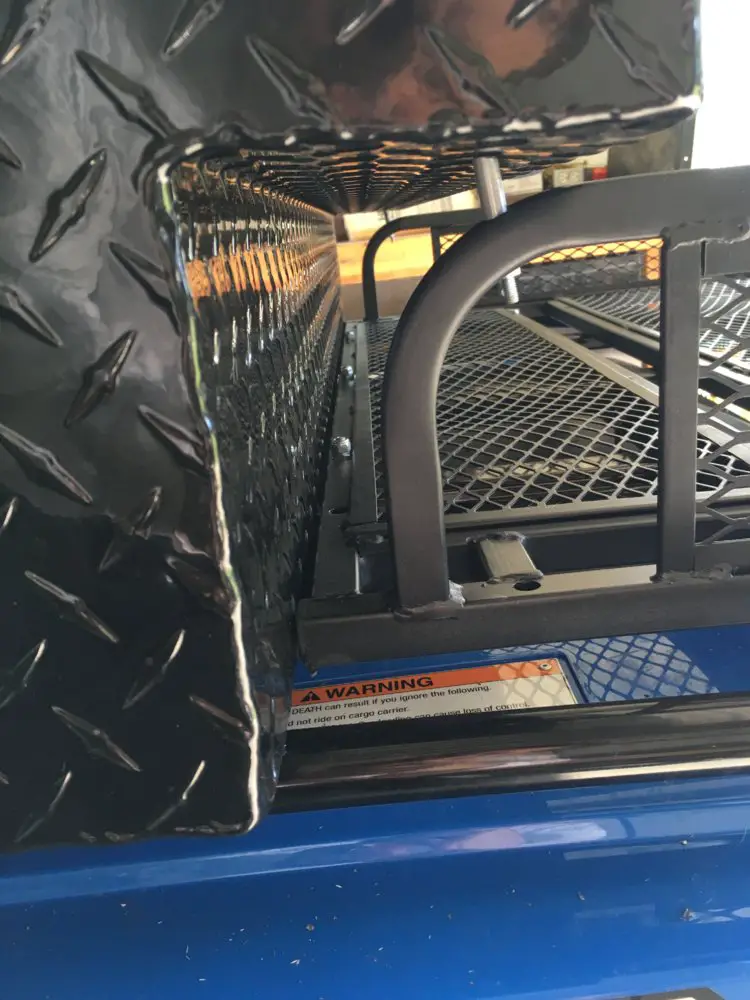

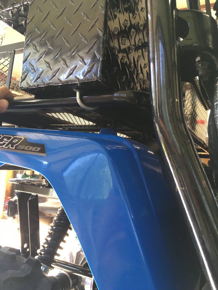

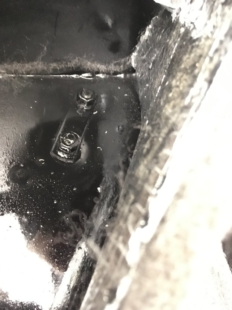

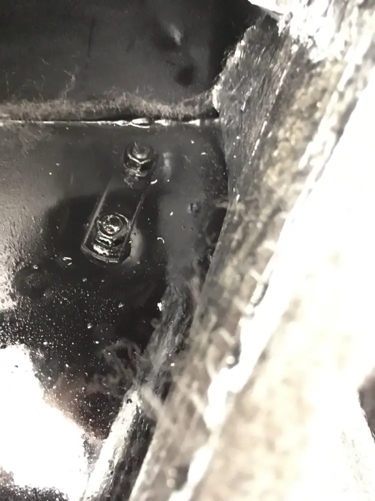

Here's some pics. Basically, Ubolts on the 2 corners, ground down to the tops of the nuts. Rubber washers. Black paint.
Then I tied the box to the rack w 1" spacers. And of course the rack is bolted down the the rack... So it all comes full circle.
Oh, I bought some of the automotive heat/sound insulation $40 Amazon. Cut a 6.5" strip and put it inside the box to cover soften and pad it all down. Looks clean and finished.

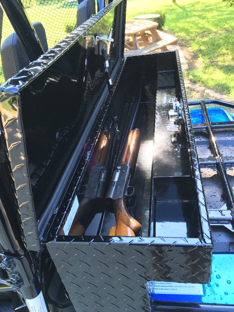

I was just practicing, today, and this 12 ga is (currently) the longest shotgun I own... I know a soft case or gun sock is needed, but lockable, dry storage... Squirrel hunting just got real.
This is a great idea! I was wondering if you had done this enough to perfect it? Is putting in in a soft case enough to pad it and stabilize it from being tossed around?
Reactions: Jshell3
Jshell3
Absolutely. Works great. Stuff clothing or your hunting bag around any empty spaces. Keep your scope pointed up. But yes, it works very good!
