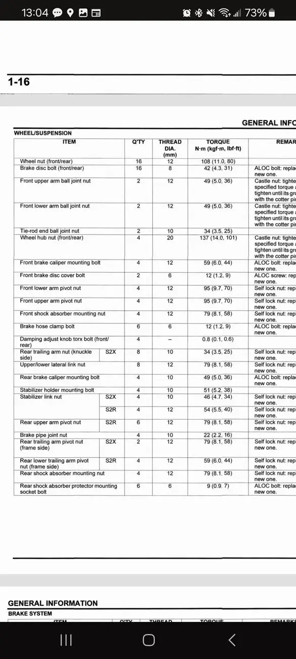

Looking for the torque spec for the a arm bushing bolts on a 2020 Talon 1000X-4 FL.
Maybe I need to ask for a service manual for my birthday.
Any help here will be greatly appreciated.

This is from the 2019-20 S2X/S2R manual:
Screenshot 20240907 130412 Dropbox
