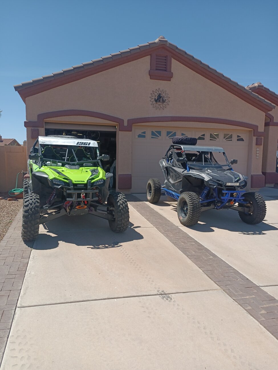

Hello Everyone. Dose any one know if you can by pass or take that steering sensor out of the loop or not run it. More pain than its worth. On a 21 R I use for a practice car. Insurance total I picked up with 750 miles just needed a cage and to have the plastic put back together and a lot of push pins. Thanks to all.
Talons

Hess makes a LV override, but it just softens the shocks when on.
I'm not aware of anyway to bypass/remove the SAS from the system.
