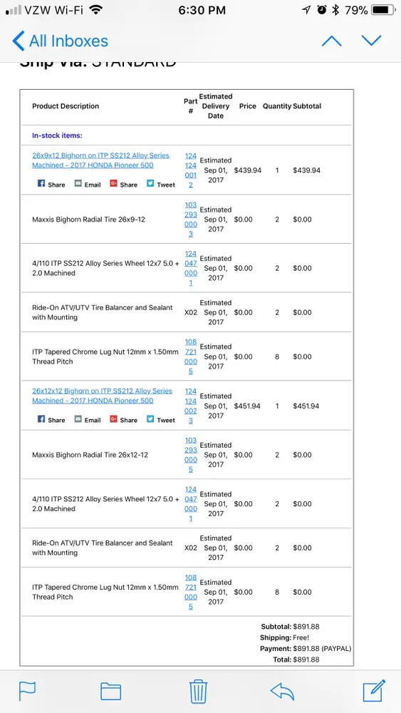

I love my 5/2 offset rims and original Bighorn 26” tires from Rocky Mountain, I also got the ride on tire puncture put in when they mounted the tires. Attached is exactly what I bought after much research. The 26” tires gain you about 2.5” of ground clearance since Bighorn original run big: View attachment 59174View attachment 59175View attachment 59176
I tried to zoom in, but could not read it.

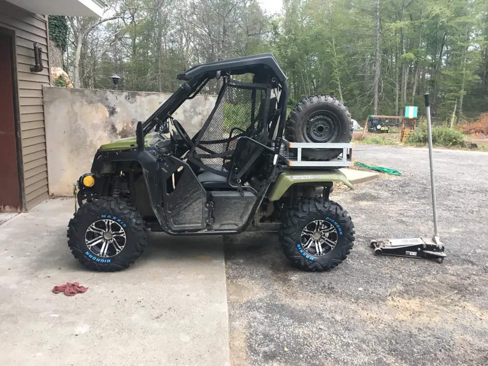

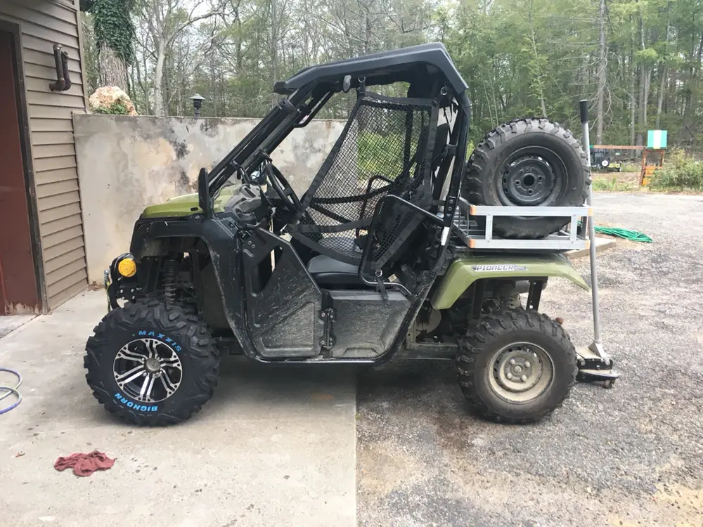

Today I moved my 1.00" spacers to the front and installed 1 1/2" spacers on the rear.
This is my setup now:
Front
26x9x12 Bighorn Originals , mounted on 12" 5+2 wheels with 1.00" spacers=54 3/8" width.
Rear
26x9x12 Bighorn Originals , mounted on 12" 5+2 wheels with 1 1/2" spacers=54" width.

Chooglin would you mind posting a pic of this new set up?
