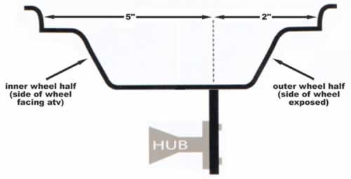

I've got 950 rough miles on the stock rims and tires...the tires are looking pretty worn. I have read several comments about what others are running, but there seems to be so much information for a newbie, the information is overwhelming trying to figure out what sizes of tires and kinds of rims to purchase.
I'm not sure if adding spacers is for me as I have to go through those 50" gates out west often.....but, I could easily be convinced that a wider stance is worth it.
Where do I start trying to figure this out?
Thank you in advance.

It seems the majority of the 500 owner go with 5+2 wheel and 26"-27" tires. The next question is , what width tire do you want to run, front and back. I personally like the same width on all four but that may not work for everyone. This allows you to carry a spare ,that will work front or back and it allows you to rotate the tires.
If you go above a 28" tire , chances are , you will rub on the frame but not in all cases ,it depends on the wheel tire combo you choose.
As far as spacers , I like them , they definitely make the 500 more stable , especially if you go with a taller tire!
I am sure others will chime in , this is my take on the subject!

15 rims, 5/2 offset, with 27 tires, Bighorn type tread, no rub, about 54 inches new width. No regrets, big improvement on looks and performance.

It's how much the wheel is offset from the hub ,inside and out !
52 offset

I love my 5/2 offset rims and original Bighorn 26” tires from Rocky Mountain, I also got the ride on tire puncture put in when they mounted the tires. Attached is exactly what I bought after much research. The 26” tires gain you about 2.5” of ground clearance since Bighorn original run big: 4890d82bc9adbcc54cc71056dee7e4751bbc4b62386d45006eed65b3566eaf383e1430adc38d7fdde3aed754af934bd0

I went with the 5+2 ITP steel wheels 12" tall, they cost bout $40 - $45 each and seem sufficient. After I purchased the rims that were in the "What fits my machine" selection someone on facebook found the same wheels with another inch of stick out that was not on that list but fit fine. If you can find those you would not "Need" spacers to get a little more width.
If you are not a rock crawler and do not need to Air down and have a big ole sidewall for flexin I would suggest getting a 14" diameter wheel, that will give you a lot more tire choices in the future, even cheap light truck tires.
Other than that I think these guys have nailed it down. I would add that in my opinion life begins t 28" tall on these things. I run a 30" and feel it's about perfect, and I tend to follow where I should not (behind drunk idiots that really should be on youtube.) Tread patterns and overall diameter and width are really a regional thing, I ride muddy hillsides and need an agricultural tires that can let me climb tree roots and rock ledges like a ladder, but if I were out west my needs may be different.

What is a 5+2 wheel? What spacer did you use? I'm trying to put in an order in with Rocky Mountain, going with 26" tires...have no idea yet about wheels. I'm not sure what changing the tire width does to handling or if it is an advantage other than having the same wheels and tires for both front and back ??
