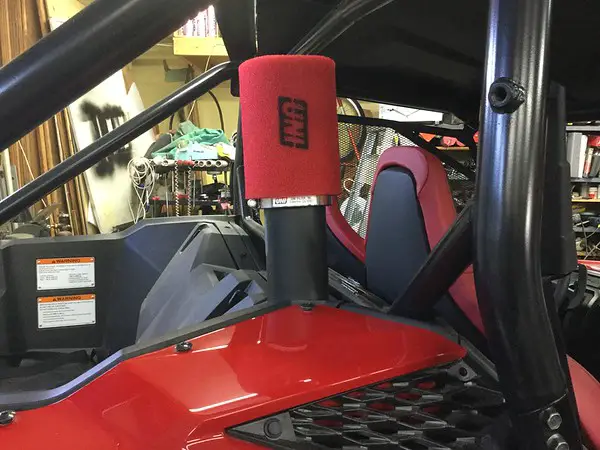

Does tacobob oil that ink filter or is it dry ?
The intent of foam filters is for them to be oiled, that's what makes them so effective.
My point - if you're going to use a foam filter, oil it, it's how they work.

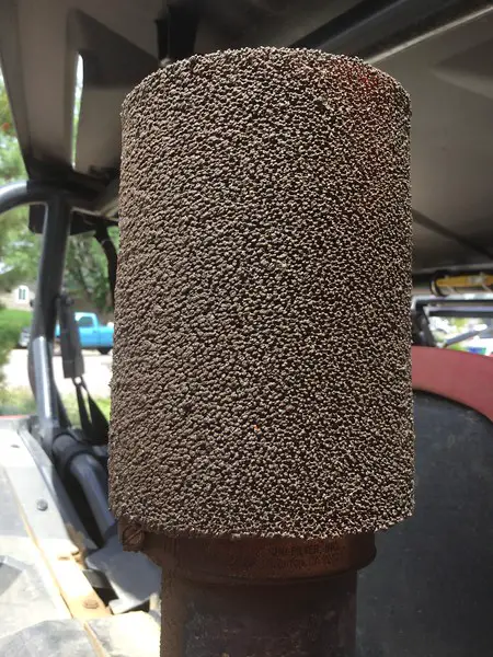

On my Talon -
I gXGK7GX M
At 1066 miles -
I KRxxBDV L
The stock filter at 1137 miles, their reputation is to need replacement at 200-300 miles.

On my Talon -
At 1066 miles -
No you didn’t read what he uses the uni filter for .
he uses it as a pre filter under the oem cap . I want to know he oils that too
pretty simple question
Regardless of its location, filter foam works much more effectively when it's oiled - whether being used as the primary filter or pre-filter.
Pretty simple answer.

HondaBob snorkels his inside and then puts a cone filter at the top of the snorkel . His regular filter doesn't get dirty at all .
TacoBob puts a peace of unifilter over the original intake and then snaps the cap back on . Clean/change filter at each oil change and it barely needs cleaned . If your only going for cleaner air , TacoBob's way is MUCH easier .
