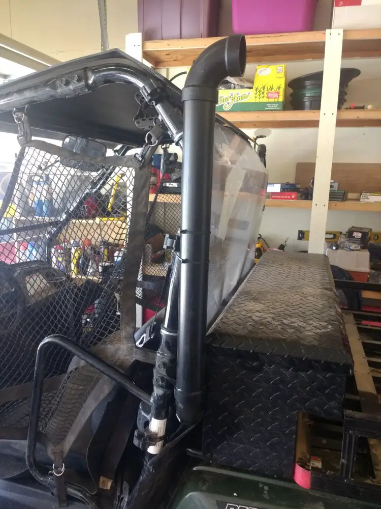

I used the existing sound chamber but snorkeled to the outside. I have a back panel that must create a dust vacuum at the factory intake and I cannot believe how quick the air filter gets dirty in dusty conditions. Like it can be shot in one good ride. I found this thread from @Texas_Newfie and modeled it almost exactly.
P500 - A Simple Snorkel
It has helped a ton. It hasn't got real dusty here yet so the true test will be later in the summer but sucking air up high has to be much better than a foot above the tire.

That would be torn right off around here. Depending on the trails you ride, I'd recommend keeping it within the rops.
Never rode in one drawing from inside the cab but have read that it's louder. I run as many pre-filters as possible, panty hose on the tips and pre-charger around the K&N.
It is a nuisance having to watch out for it when riding tight trails. I very well may make another one that is within the ROP at a later time. To do that I would need to move my box and rack rearward and they are all drilled and bolted down so I went with this config for the time being. Having it punch through the back panel like you have would be another option as well.
