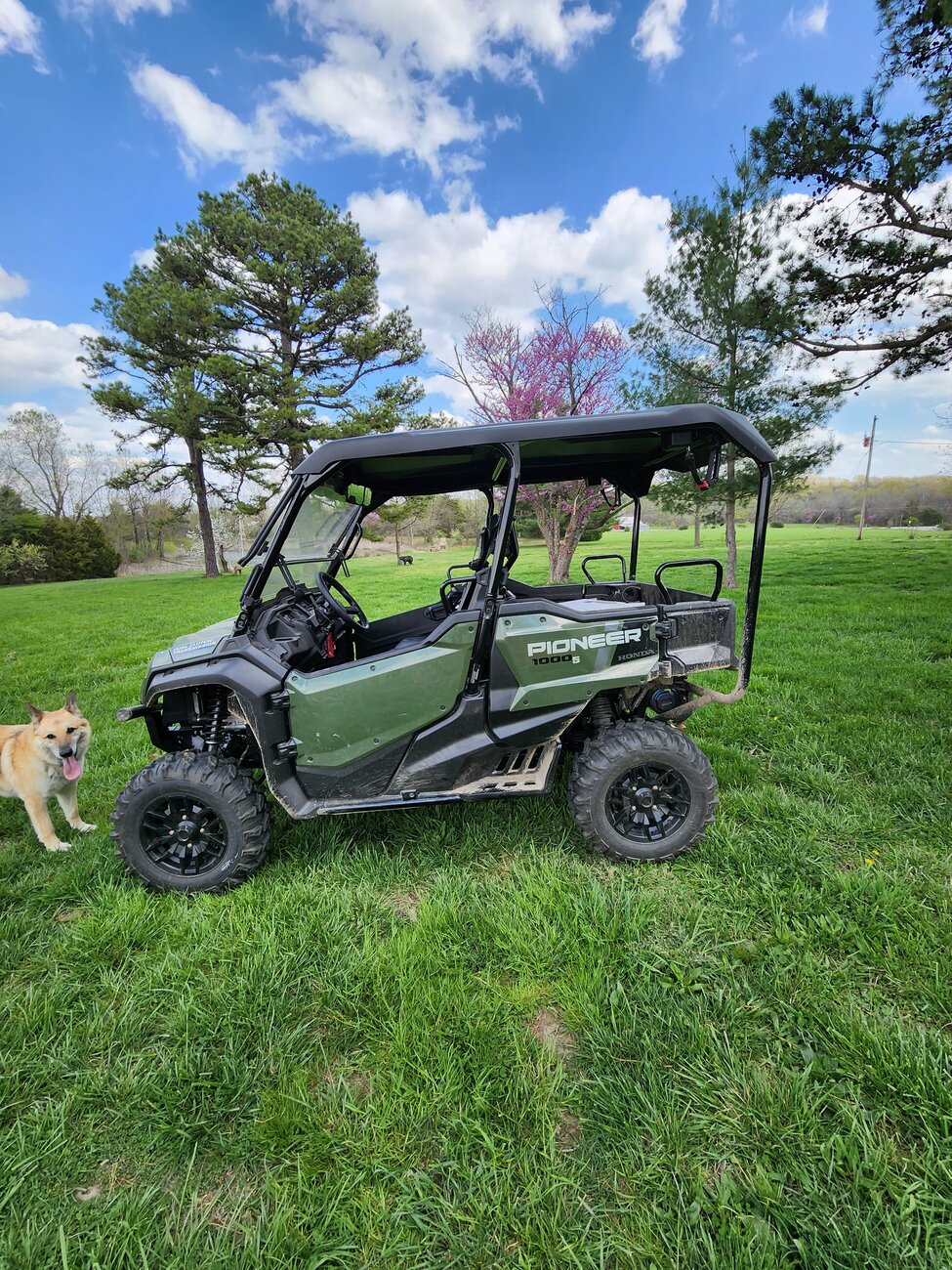

Just did the first service on the old girl this morning. Haven't been that oiled up since my college days. What a hot mess!

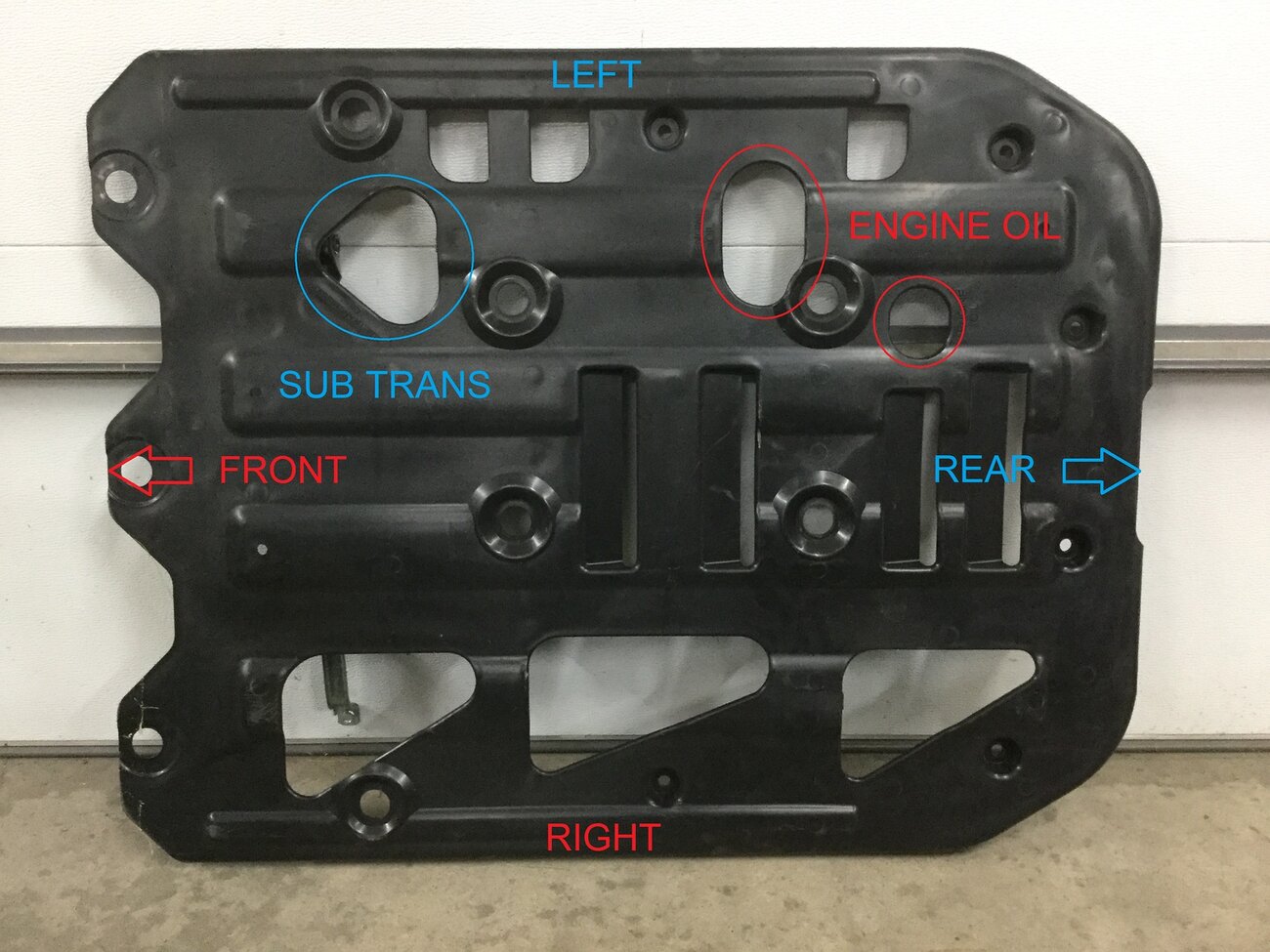

Isn't the oil change a mess, did you try changing it with the left rear wheel removed ? It makes changing the filters easier to see and replace. The two filter springs are easy to lose on your first oil change.
