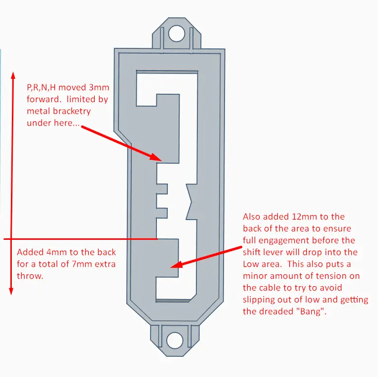

If you are worried about the sub-trans, shoot me a PM when you get your Talon and I will sell you a specialized shift gate that has more throw and a more positive Low engagement. My 2019 R did the shift "Bang" once at about 200 miles so I engineered a better shift gate. 3000 miles on mine since installing my upgraded shift gate and I NEVER look at my shift indicator anymore and have not had any more issues.
View this thread starting here for more detailed info...
Early prototype looked like this...
1612073230746
I now have 2 CNC cut ABS versions available. There are others out there but mine is the only one that I know of with the small Low gate to insure better Low engagement...
1612072877157
1612072897971
This is the way. ^^^^
my prototype version is flawless.
be aware of the indicator.
Ride it.

i agree on Paul's gate. Have had it so long basically forgot about it. Never an issue so far. Install, adjust cable & forget
