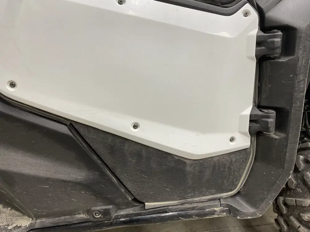

I can open the door and drain water but I couldn't close it hard enough to keep dust out (it pours in through the gap in front doors on a gravel road) so I decided to make my own seals which IMO look as though they could be OEM.
The following were all purchased through Amazon for under $40.
1.3M 4298 Adhesion Promoter, 5 Sponge Applicators
2. 3M VHB Heavy Duty Mounting Tape 5952, 0.5" width x 5yd length
3.3M D-Shape Door Seal 0.59" Height X 0.47" Width, Weather Stripping Hollow Black (10 Feet)
View attachment 92639 View attachment 92640 View attachment 92641 View attachment 92642

I have all the exact material, and I'm ready to install. One question if you don't mind. On the bottom, front of the doors the plastic door gets really narrow. Did you just follow the ridge of the door, or did you go in a bit where you could get where it's flat. I was going to take the tape inside, but the picture looks like you went right down the edge. I assume you went around the door with one contiguous length of tape and door seal material.

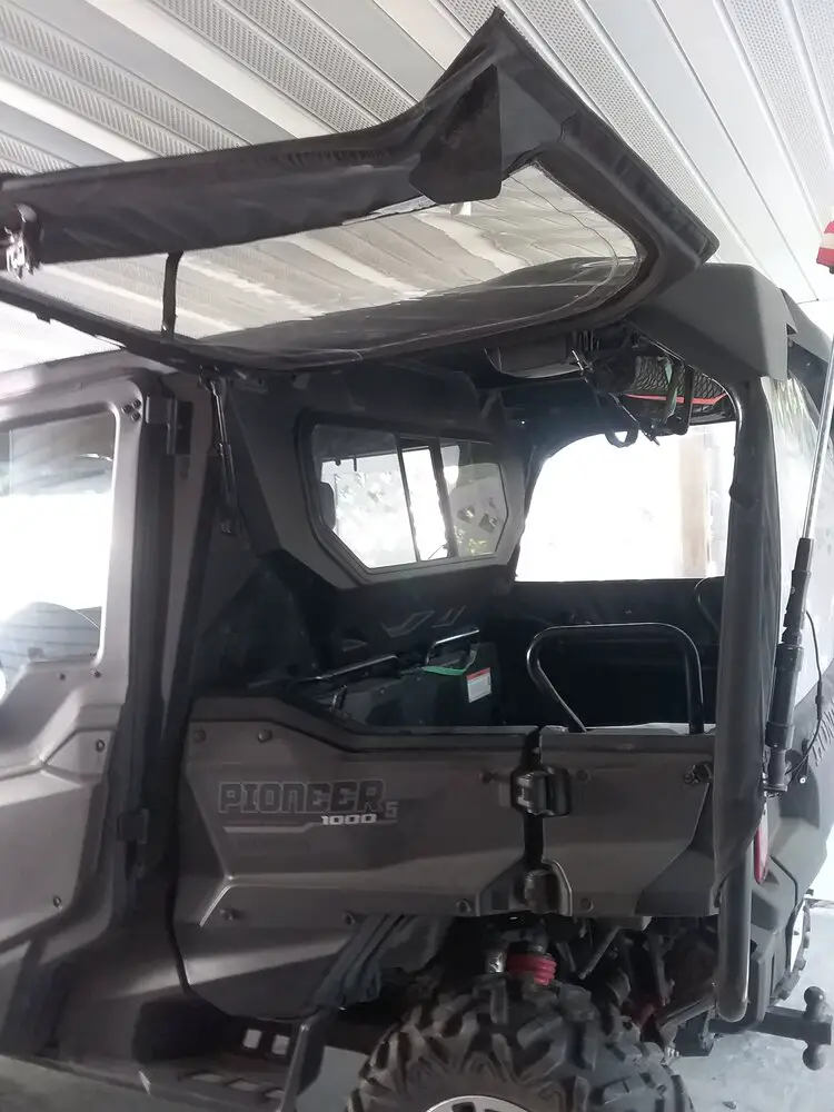

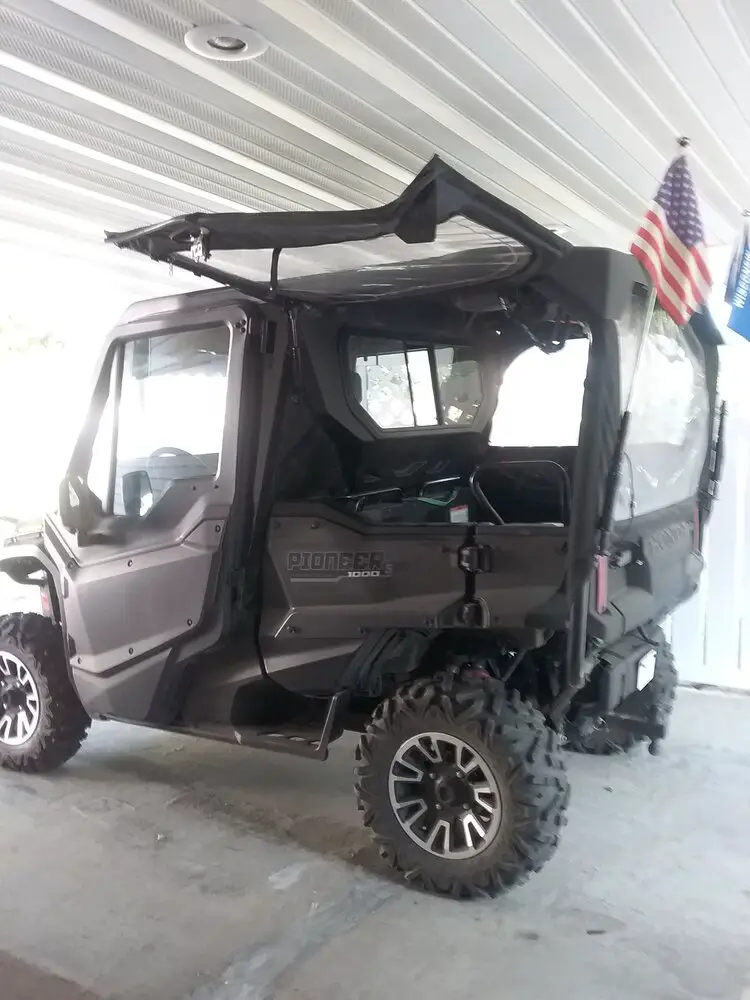

I made a mesh rear windshield. It helps, but there's still a lot of dust piling in back.

I used one continuous loop along the very bottom, doesn’t matter how thin the door gets just mold the seal to the door. The s***’s sticky and it will adhere. Never pull on the material or you’ll flatten it out and have gaps. Take your time and let the seal keep its original shape and size around every bend.

I went in a bit, where it is flat, (as you suggested). It's important to apply as much pressure as possible, and then leave it undisturbed for 24 hours or so (it's tough not to try opening and closing the door a few times, but the adhesive really does take some time to reach near full strength).
At least on the Pioneer, the lower front corner of the door is a tight radius. So much so that it will tend to stretch the outer seal edge of the weatherstrip, while compressing the adhesive side. This causes the outer seal edge to move in towards the adhesive, leaving a gap between the seal outer edge and the door frame.
I haven't fixed this on mine yet, but several possibilities come to mind. Firstly, the weather strip is hollow and if water gets in, it won't drain unless there is a hole/s at the lower part. Cut off the weather strip (remove a section at the forward corner radius). replace this with several small sections, each cut at an angle so the adhesive base is shorter than the outer surface (trapezoid shaped). Hold a piece in place without sticking it, to check and see if it'll fill the gap. If it doesn't, use one of more strips of double sided 3M VHB tape to "build up" the door edge to close the gap. Then install several of the short length so seal radius of door.
Also thought about shaping a piece of hard rubber to attach to the floorboard/door frame to provide a seal for the forward edge of the door to come up against.

Hey, thank you very much for the info. I used my Dremel to smooth out the seam, and I should be ready to do the job. You say let the seal keep its original shape, I take that to mean that I should not try to form it around that narrow part in the corner of the doors. Without you input, my instinct would be to bend over the sides of the tape. I may actually get my wife to go on trails again. LOL

I finally got around to installing the door seals on my P1000-3 as 301 was good enough to provide the pictures and guidance. The job went well, but I may have a 6" area that I might have to re-do. I plan on buying some single sided insulation tape to provide a little better seal on the slight opening at the front, bottom of each door, and I will get the 1/8" or 1/4" thickness depending on the gap.. I thinking of cutting approx. 8 inches of the insulation tape to affix the the door frame for both doors (Amazon's B07S1HXZ4 or similar - many sizes available). I really appreciate the info 301 provided which I followed to a "T". Now for turn signals and something to block the air stream coming in around the shifting levers.
