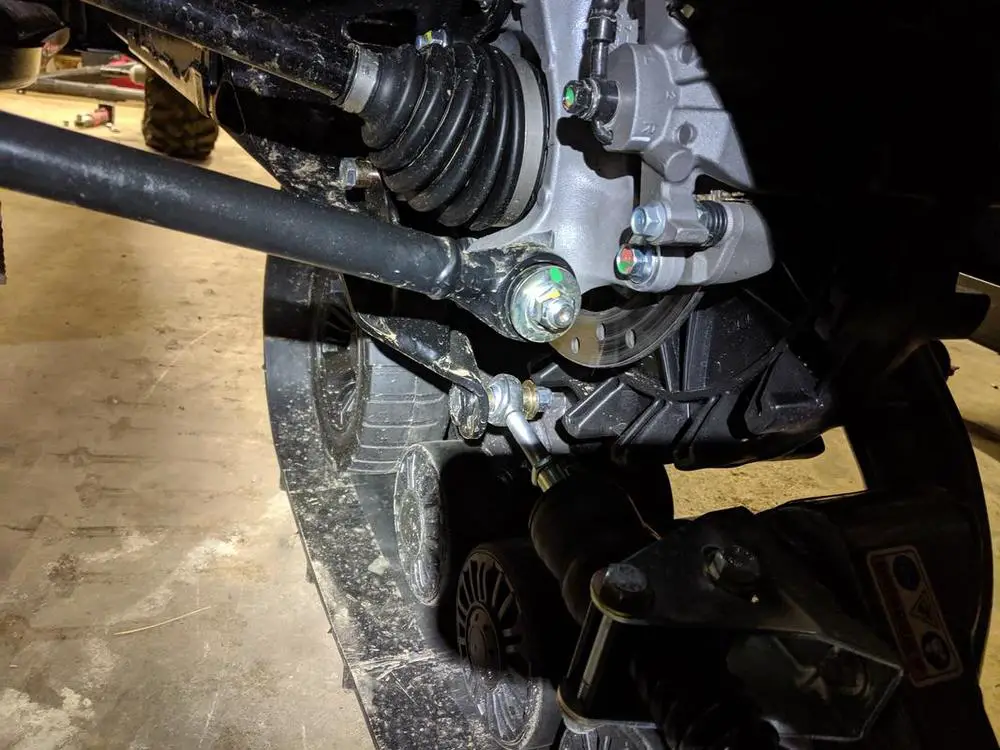

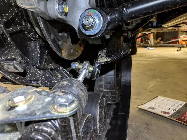

I would box it. Make sure add on plate goes up original plate a bit to add torsional strength
Not the best pictures, but that's what I have right now. I like the way they mount to the machine, just not the cheasy single shear tab.

That's my plan. Just can't decide if I should just up the hiem size at the same time.
I stayed with the stock hem joints. We haven’t broke one since I did mod in dec of 17 I did my mod on 1 Polaris 900 ranger and 2 Honda P1k’s.

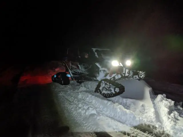

After loosing my 1 ton 4runner on 40" tires in the fire in 2018 I had to get another toy to go play in the snow. A few of my buddies have rzr's with tracks, but I've never been a big Polaris fan. So after some research, I picked up a talon and some tracks :D
Last night was the first trip on the tracks, man it's a blast. You can go places that guys even on huge 54s can't dream of.
I will say the trans isn't super happy in the snow in auto or sport mode. It likes to jump back and forth between gears. I found using manual mode when really mashing worked better. I haven't got to ride in another rig yet, but I do wonder if the cvt may have a slight advantage here. It's what's snow mobiles use after all. Either way, it's an all season machine for us, so I'm still glad I went honda, I didn't want a rubber band trans.

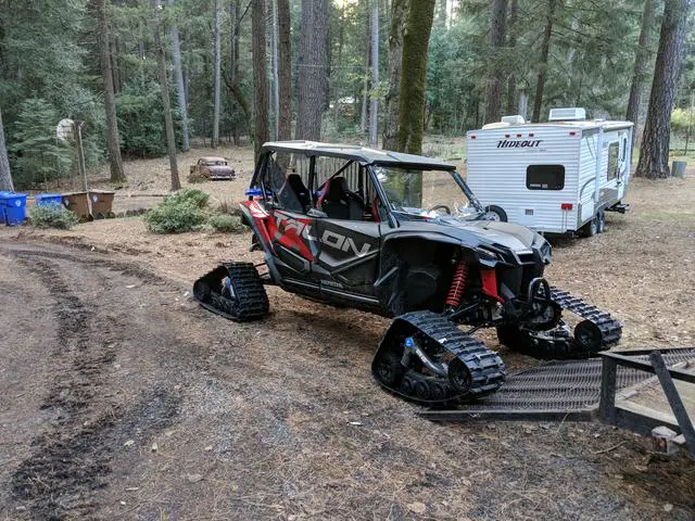

How much longer and wider did the Camso tracks make the vehicle? I have 14 x 7 trailer I'd like to keep using if I pull the trigger on these.
R
rickoshea
offset length 26.5" front/35" rear from the center of the hub width around 7" per side height will be roughly 4"
