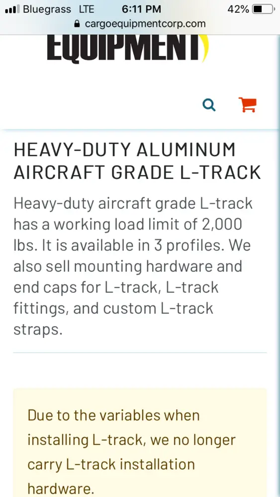

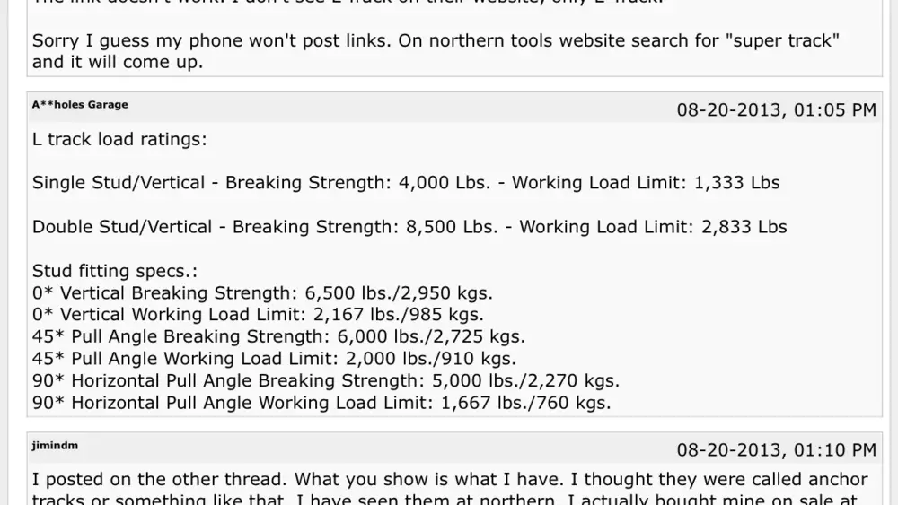

Looking at tie down options and I like the versatility of the e track systems.. but I ran across L track and like the smaller foot print.. anyone used the L track?
