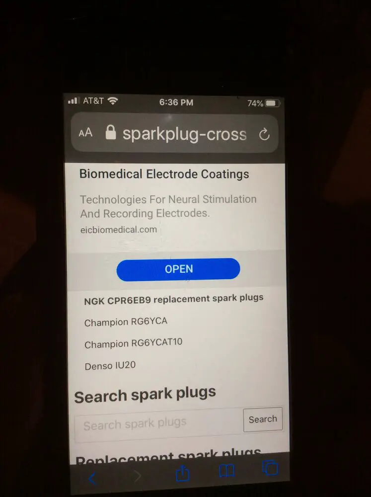

Do you know the crossover part number? 🙂 Could you post a link, please? 🙂
R
RandalH
Oct 30, 2020
24
38
Louisiana
Just did a search..
