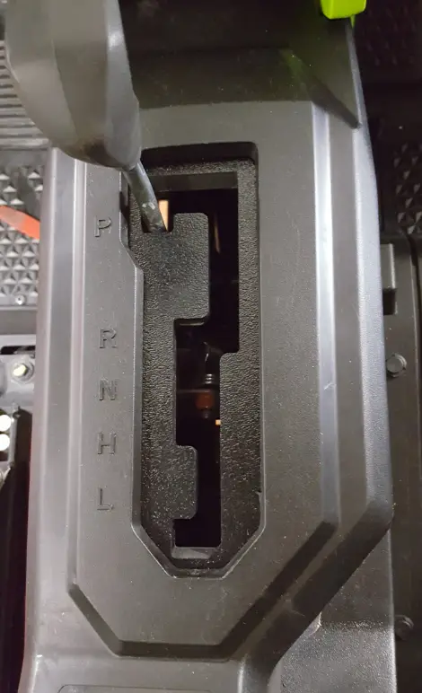

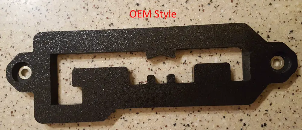

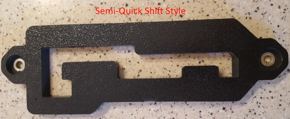

Some of you have had issues engaging Low Range or staying in Low and getting the dreaded "BANG!". It happened to me last fall so I designed a Modified Shift Gate to help alleviate the problem and 3D printed a limited number of them. So far, the reports are excellent and the demand was getting too great so I have gone to a solid ABS Plastic CNC version that takes MUCH less time to produce so I can now fill the demand. Both OEM and Quick Shift designs have been converted to CNC and I have included pics of both below.
Although there have been no reports of any issues with the 3D version (there are dozens of them out there), I changed to CNC for more production and it is a little nicer looking. Anyone that purchased a 3D version can get the CNC version by paying the difference and I will cover the shipping (to the lower 48).
For those of you not aware of how these modified gates help, here is a quick explanation. Even with the shift cable properly adjusted, the shift lever hits the back of the stock shifter gate and sometimes does not engage the Low shift dogs all the way, especially when the dogs are not aligned. In some instances, you can have the lever in the Low gate but the Sub-Transmission is either not in Low or not fully in Low. This can cause grinding and even the dreaded "Bang" that many have experienced. Honda has not come up with any solution as of yet so to combat the problem, the modified gate has been designed as follows...
  • Moved P, R, N and H forward 4 mm and moved Low 3mm to the rear to give Low a total of an extra 7 mm of throw.
  • Narrowed the Low gate so that you cannot move the lever over into the Low position unless the Sub-Transmission is full in Low.
  • If you do pull it back into Low and the shift dogs are not fully engaged, there will be some preload on the cable/linkage/fork/dogs and this preload will help the dogs fully engage when you start moving. This seems to have eliminated the "Bang" issue so far.
Final design and tweaks are now complete and production and shipping starts Monday. I have enough material on hand to cut 100 units but I already have quite a few pre-orders and my local dealer wants some so there won't be too many of the initial 100 left. Get your orders in now so I know how many of each design needs to be cut. $50 shipped to the lower 48 and additional shipping charge to Alaska, Hawaii and Canada (it has been around $5 more).
To order, PM me your PayPal account email AND tell me what version you want...
