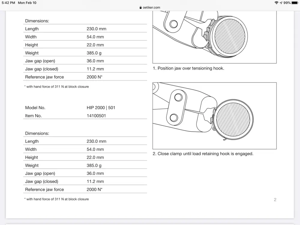

I have spent hours on this and have learned a lot about clamps. Have found that the tool is HIP200 500. The tool would be to large to use without completely removing the axle from the machine.

shown above? If so I have used the tool I liked above to close before - i Did have the Axle off the machine and it was a pain..I believe I even put another pair of channel locks on the handles to help close

I believe it they are crazy tight, impossible to do on the machine. I guess I will just give up and use the ear type clamps just like they did in a Pioneer thread. P700 - Oetiker clamp tool
