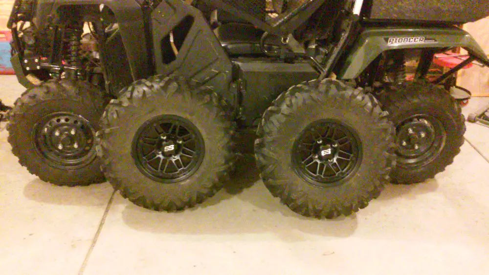

Well I got the new ITP Black Ops installed. Went into it based on info from the forum in regards to offset (5+2 on all four) and spacers (1" on rear) to achieve an even track width.
I pulled the spacers off the front and mounted the two on the drivers side last night, looked like the back was wider than the front...maybe optical illusion, I'll check it out tomorrow. o_O
Installed passenger side today and dropped it down, took a level and plumbed down the outside of the tires at center of hub on each and marked the the floor with a crows foot. Pushed machine forward and measured between. 53" dead nuts in front...( you were right @Chooglin ). Measured the rear, 55 3/4"...what the...?! :eek:
Thought maybe I marked the wrong side of the level so I did it again, front 53" again, rear 55 3/4". Pulled the back wheels off and removed the spacers, plumbed down again, 53 3/4". Then it dawned on me, Chooglin is probably running the same size tires all the way around for his spare tire purposes. :rolleyes:
Anyway, I now have four 1" spacers sitting on the bench. Just an FYI, for those concerned about the nuts coming loose on them, I used red thread locker on them when installed, they were tight as hell and I had to use a persuader to get them to cut loose. I also have four stock wheels and tires leaning in the corner, lug nuts too. The tires are brand new, still have the little tits on them. :oops:
Oh, and I have a P5 with some BA looking wheels on it now! :cool:
ITPs installed
Jshell3
I'm digging those tires and rims. The wasted 1" spacers are unfortunate, but I'm sure they'll sell quickly on here (along w/ the stock tires). Looks really good, tho.

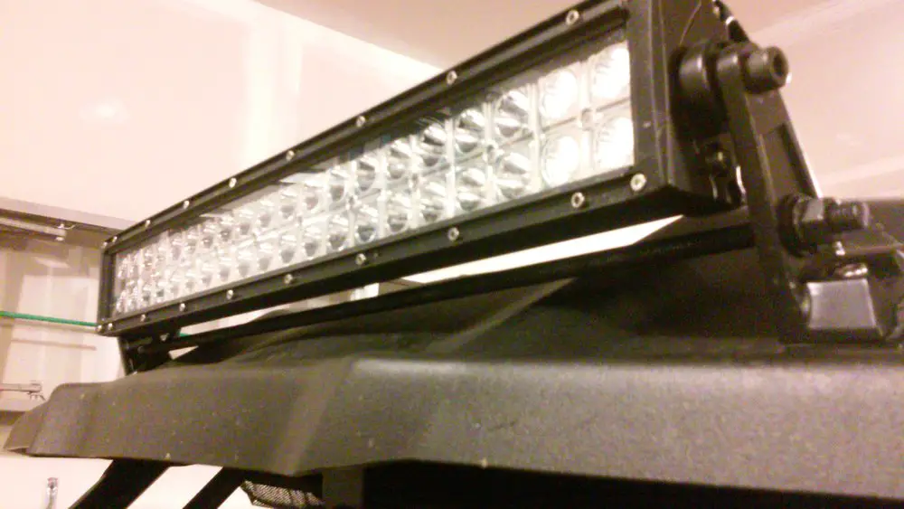

Tackled another mod today that I haven't had time to get to...the @jak9922 Rod. I think you did this one too J, if I remember right? It was way easy but necessary IMO. I actually had one of those Allen bolts come out of the side of mine on the trail and the light bar was hanging and bouncing around. I can't remember how I dealt with it out there to get back but that sucked! Never again now. ;)
100% correct!!!!

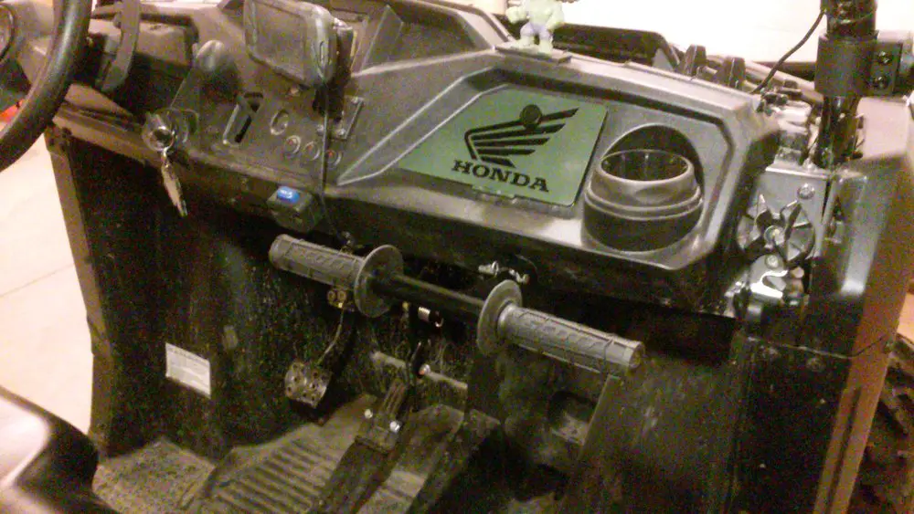

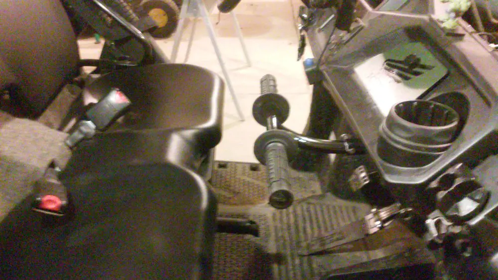

Got my reconfigured to fit the glove box @jak9922 Bar today. This thing is BA! I think this is the first thing I've ever done to this machine that the wife liked more than me. After I got it installed I told her to come out to the garage and check this thing out. First thing she said after sitting behind it was ' wow, this thing is cool, I really like this, you need to thank that guy'. Perfect height, feels solid and much safer than the stock up in the corner grab bar. Excellent add on for your partners in crime.
View attachment 37256 View attachment 37257
Thanks jak! :cool:
awesome glad you guys like it

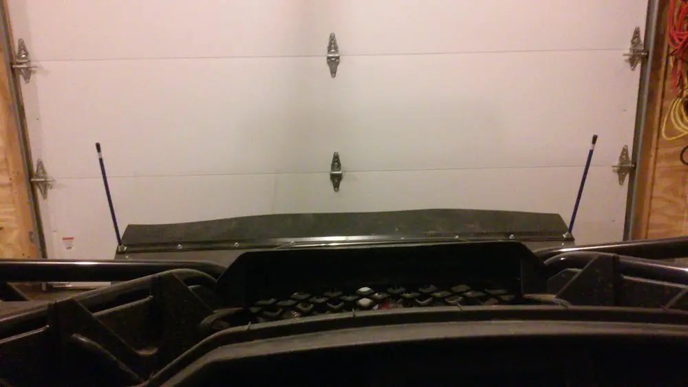

Put a bigger graphic on the hood, just looked too small after seeing that bear head on Blue Berry. :cool:

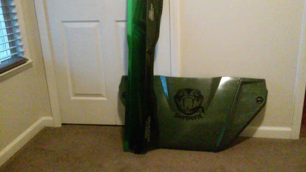

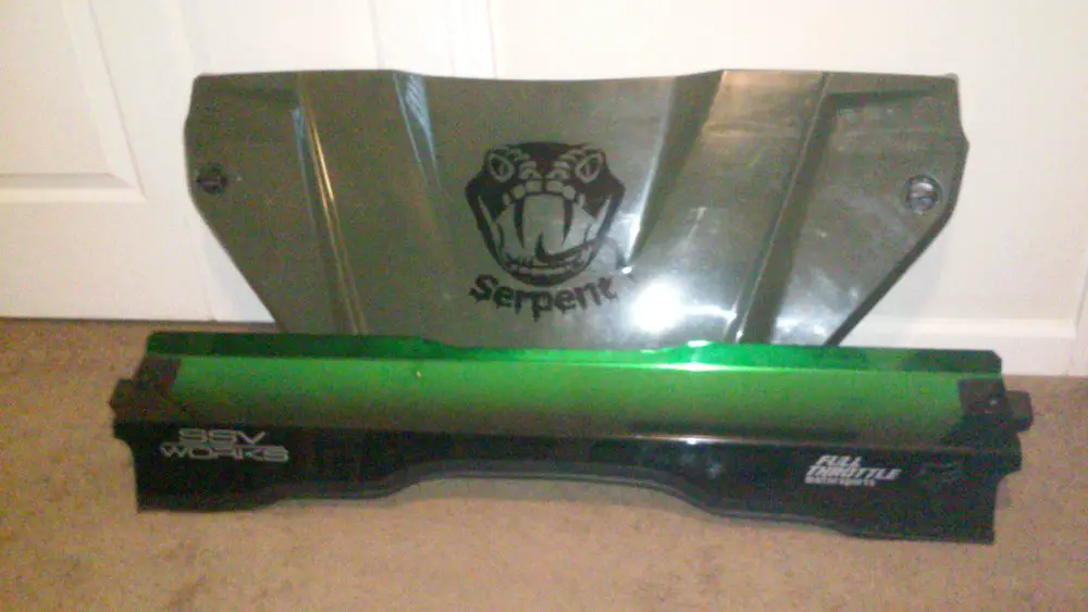

Tinted the half shield with green fade to black. First time I ever messed with tint, wouldn't say it was hard, but it was time consuming. :rolleyes:
View attachment 36278 View attachment 36279
