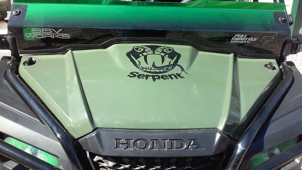

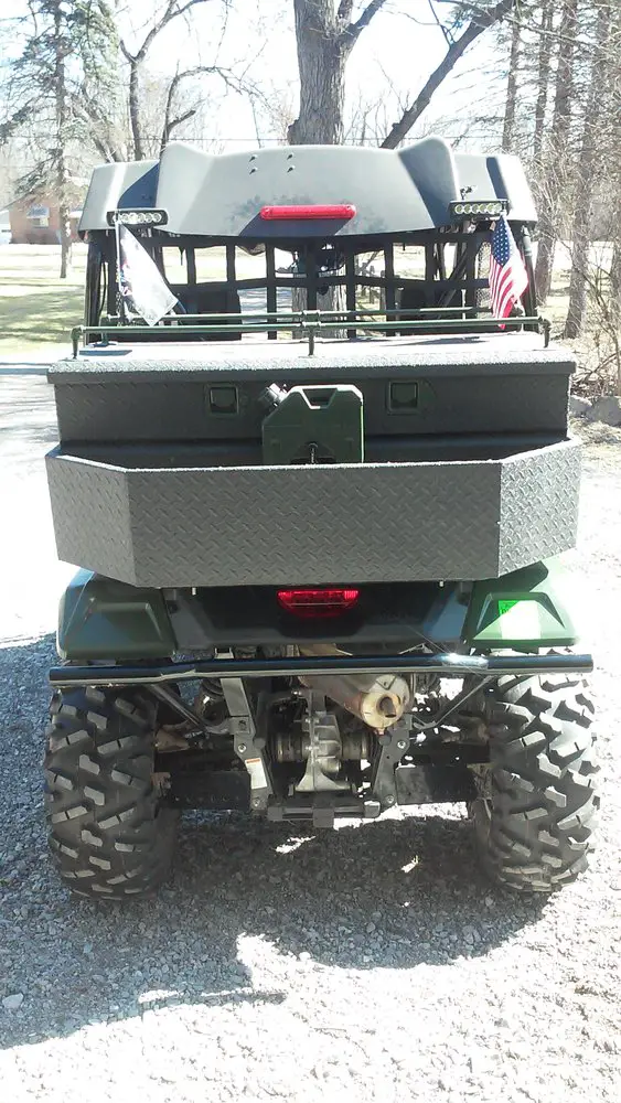

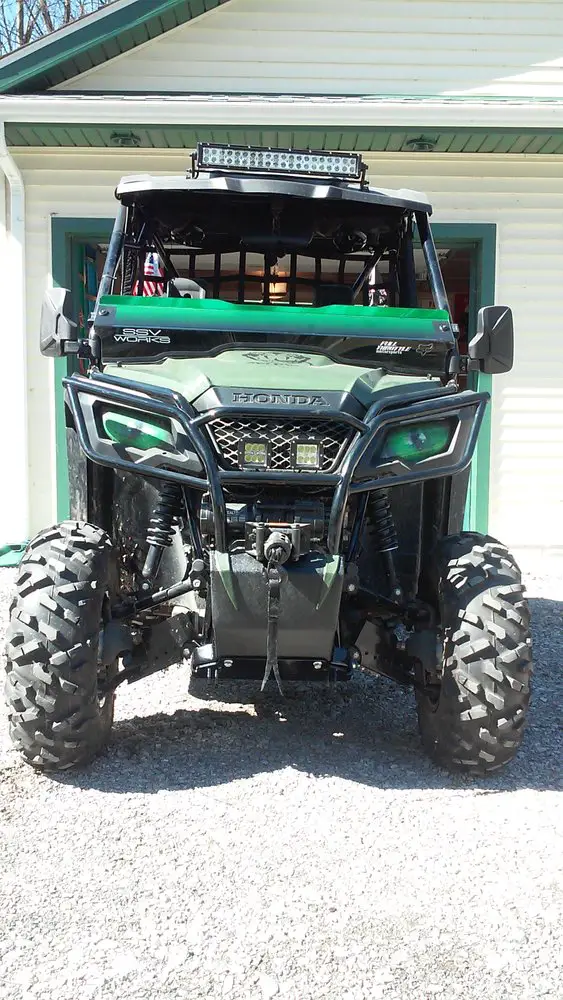

Been working on the trailer lately but took a couple of pics just to share.
Skid plate Line X'd, hood graphic and half shield tinted. Second brake light for visibility over trailer.
Trailer is starting to come together now. I'll post some pics when complete.
Front
Hood
Rear Brake Light

The split tongue winch strap is the best subtle detail. its the little things that really bring a whole ensemble together. EDIT just also noticed the fangs. :)

Wow , that thing is looking sharp..........loving that winshield!
Yes! What choog said.
That's a standout custom look, sir!!!

Thanks guys. :)
My Line X guy kind of screwed up really. When I picked up the skid plate he said 'you got a free upgrade'. They have an optional second coating that is like a clear coat, helps it clean up easier. The problem is that it adds another layer of thickness which fills in the diamond plate. I didn't b**** though.
Windshield looks good now but wonder how long it'll last? I read before I did it that plexiglass doesn't take tint very well. Heats up and emits a gas that makes the film bubble.
That's the second strap I've made for it now, first one looked like crap, second try turned out nice, then I trailered it at 75 mph in the rain and beat the piss out of it. :rolleyes:

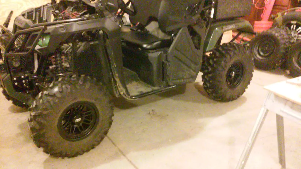

Well I got the new ITP Black Ops installed. Went into it based on info from the forum in regards to offset (5+2 on all four) and spacers (1" on rear) to achieve an even track width.
I pulled the spacers off the front and mounted the two on the drivers side last night, looked like the back was wider than the front...maybe optical illusion, I'll check it out tomorrow. o_O
Installed passenger side today and dropped it down, took a level and plumbed down the outside of the tires at center of hub on each and marked the the floor with a crows foot. Pushed machine forward and measured between. 53" dead nuts in front...( you were right @Chooglin ). Measured the rear, 55 3/4"...what the...?! :eek:
Thought maybe I marked the wrong side of the level so I did it again, front 53" again, rear 55 3/4". Pulled the back wheels off and removed the spacers, plumbed down again, 53 3/4". Then it dawned on me, Chooglin is probably running the same size tires all the way around for his spare tire purposes. :rolleyes:
Anyway, I now have four 1" spacers sitting on the bench. Just an FYI, for those concerned about the nuts coming loose on them, I used red thread locker on them when installed, they were tight as hell and I had to use a persuader to get them to cut loose. I also have four stock wheels and tires leaning in the corner, lug nuts too. The tires are brand new, still have the little tits on them. :oops:
Oh, and I have a P5 with some BA looking wheels on it now! :cool:
