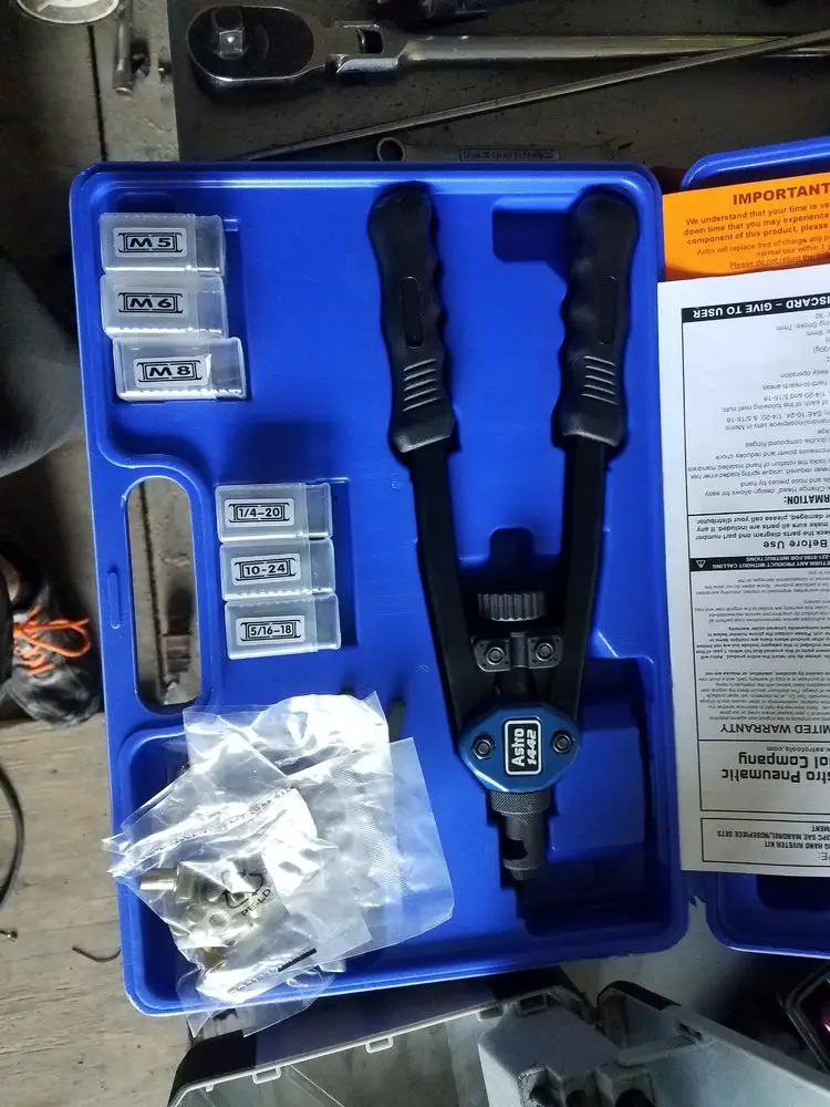

I gotta tool just for that along with standard and metric nutserts. Works like a breeze too. You decide you wanna do it holler at me.

It takes longer to drill the holes than anything. The kit i got work's great.

Too late I did this last weekend lol. I've used same piece of flat stock to install them for about 10 years lol. They aren't hard to install at all, just not fond of installing so many laying on my back lol.

Right angle version makes it easier under machine, but a little more difficult to get it seated correctly.
Haven't seen that one. Prob would help out quiet a bit. Mine is the smaller version but 90 deg would be nice.

I welded a nut to the flat for depth. So I didn't have to remove skids.

McMaster Carr has a good one, Northern tool has the disposable version. Get McMaster Carrs nutcerts as well.
Yes McMaster Carr is one of my fav places to shop. If they don't have it, it doesn't exist lol
