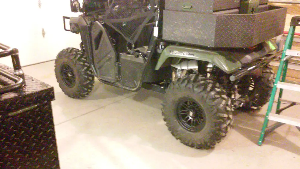

Installed the $3 trash can, installed one yesterday after reading other posts for Cheap Underseat Storage.

Found this waterproof 10 in. square box at surplus store, couldn't resist buying it. Thinking about side mount, goes with my green machine. Just the right size for side panel and 7.5 in. depth fits up against 3 gal. trash can from underseat hole. Just a thought.

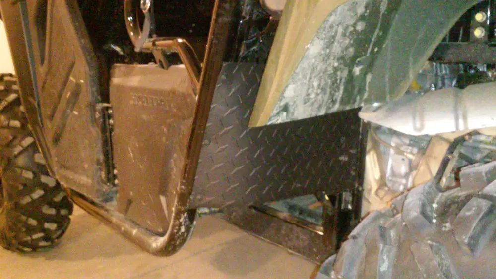

Been eyeing that framing member with the holes, there are also two horizontal pieces that run front to back on either side of seat area, kinda tucked up in there. Could use those to hang a tray from, access the box through the hole.
Here's the cover that I made so it's not getting all that mud from the wheel well. Has a hole drilled in it at the top to accept the seat belt bolt too, it's solid.
View attachment 39411 View attachment 39412 Rolled it under the bar just a little bit at the bottom.
