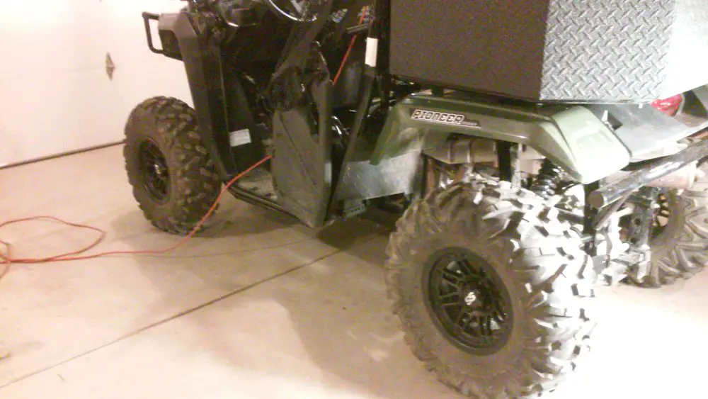

  1. 520
Got the jack mounted today. Can be accessed from top or bottom.
I'm done now, time to ride.
View attachment 40722 View attachment 40723
How did you mount your mud guard? And how is your mounting bracket holding up? I might steal your idea because I've been trying to come up with a mounting solution but yours is the best I've seen so far. I've got a 35ah Mighty Max battery coming with a U1 box but finding a solid mount is going to be a challenge.
23,829
178,016
Which mud guard, fender flares or the panel behind the drivers seat? Mounting bracket for the battery and the one for the jack are holding up great, they can't really move until the metal rots out. I searched forever for a tray and couldn't find squat so I just made one. Easy too, no welding needed.
The flap between the battery and the rear tire.
I assume you drilled into the frame? I'm trying to figure out a way to do it without drilling but will do it if I have to. I was looking at it again this evening and might try to find a way to hang it from some of the holes that are already there.
23,829
178,016
That's not a flap, it's a piece of aluminum diamond plate Line X'd like the rest of the machine. It's screwed into the rops. As for the battery tray and jack tray, they're drilled and bolted. I used to have reservations about drilling into anything too but as much crap as I wanted to add, that kind of went out the window.
