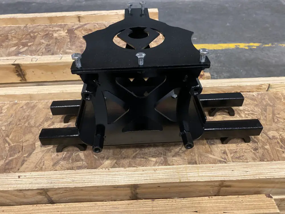

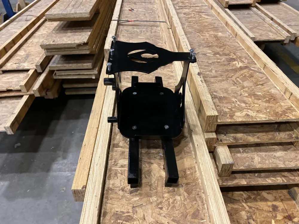

Got the jack mounted today. Can be accessed from top or bottom.
I'm done now, time to ride.
Jack and Battery Jack Tray

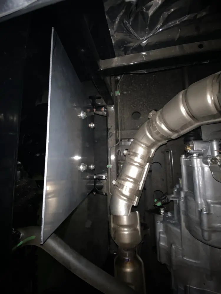

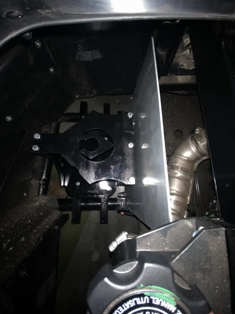

Honda knew it was wasted space so they came up with that overpriced dishpan to put in there. I'm glad they left me the option honestly. You could mount a good size jug under there for gas, fill it through the seat hole. Battery and jack are both fairly heavy items and are helping the COG, they're sitting on the frame.

It's at the same height as the stock battery, bigger and sits on the frame. Helps COG and would take up too much room under the hood for other stuff. No isolator switch either, two type batteries wired in parallel with equal cable lengths. They function as one fat bank of power and, like the stock one, I never have to see the sh**. Fuses and circuit breaker are better protected than under the hood too, it works for me. ;)
