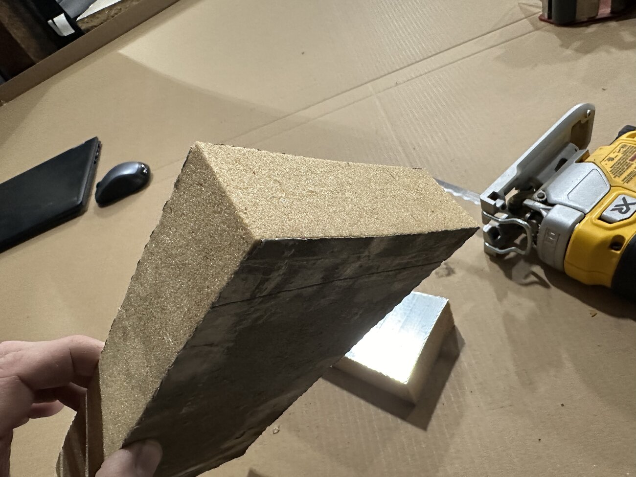

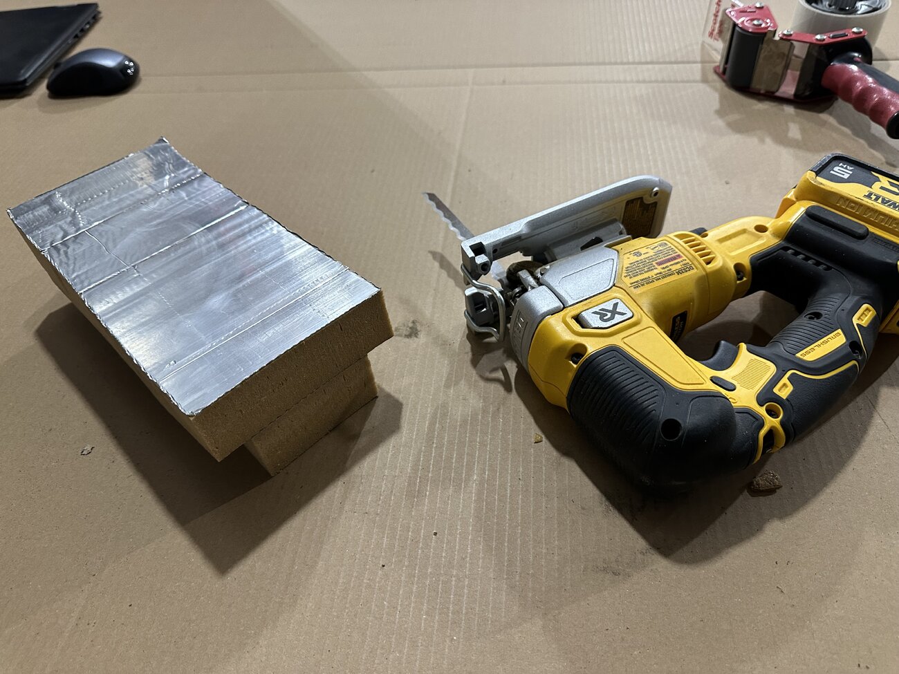

I might give this a try with my cordless jigsaw, especially notching around boxes etc.
BOSCH T313AW3 3-Piece 6 In. Knife Edge Special for Soft Materials T-Shank Jig Saw Blades
https://www.amazon.com/dp/B001J0U1HC?tag=sxsweb24-20
Holy smokes these blades are awesome in a cordless variable speed jig saw.
I grabbed some scraps and the cut is clean and sharp. Even on the lowest setting you really can push the saw.
3” stacked cut no problem.
IMG 7062
IMG 7063
The blades are sharp! There is dust but nothing like a table saw would generate.
