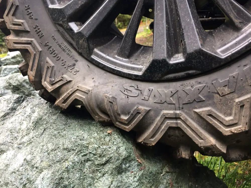

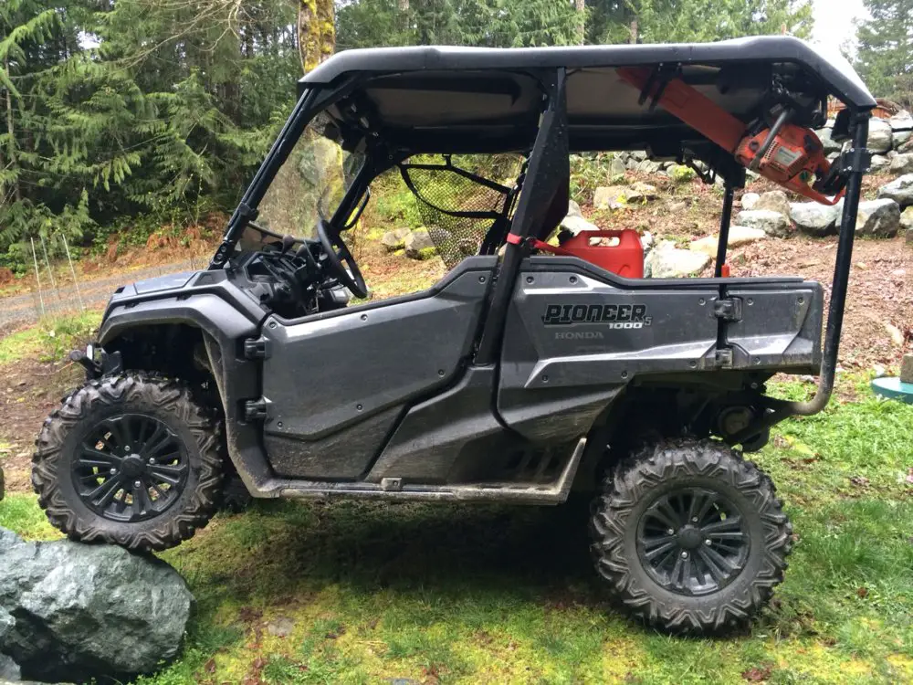

It's going on Grey. These are the OEM tires at 20psi
IMG 2601 IMG 2600
View attachment 12523 View attachment 12522
