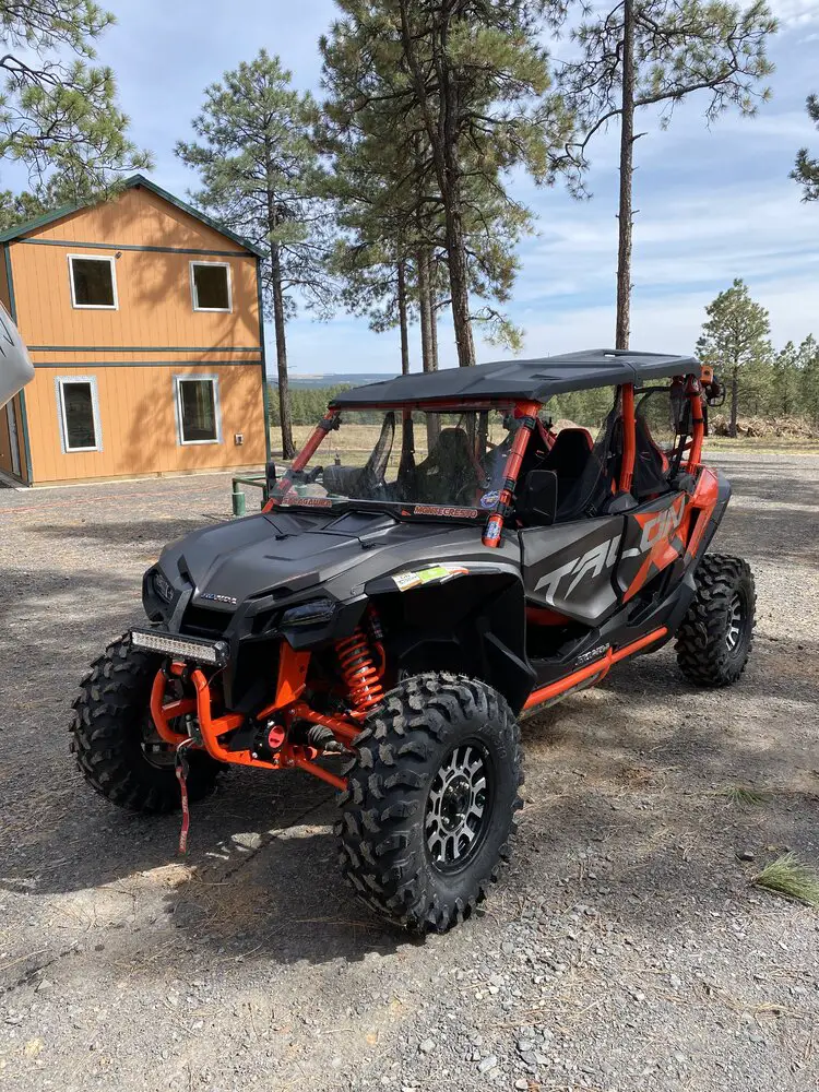

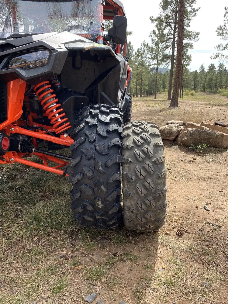

On your recommendation I purchased these tires in the 30x10x15
$664.00 OTD
they look like exceptional tires. Look good on the Talon and I really like the beaded wheel protection.
I’ll get some seat time next weekend.

Nice!
They are really tough tires.
I just spoke to a local guy with 2000 miles of rough shale rocky riding on his.
No punctures or issues.
He’s running 10 psi with beadlocks.

Have you been out since the new tires, they look good. When I started running 30's on our P1, I didn't notice much power loss and you?
34,174
Yeah, that’s because you’re riding at less than 1000’ elevation....
Yes, at 8K plus it is noticeable. I’m hoping IGR will remedy that.....
I put about 10 miles on it and am pleased with the improved traction and clearance however....
