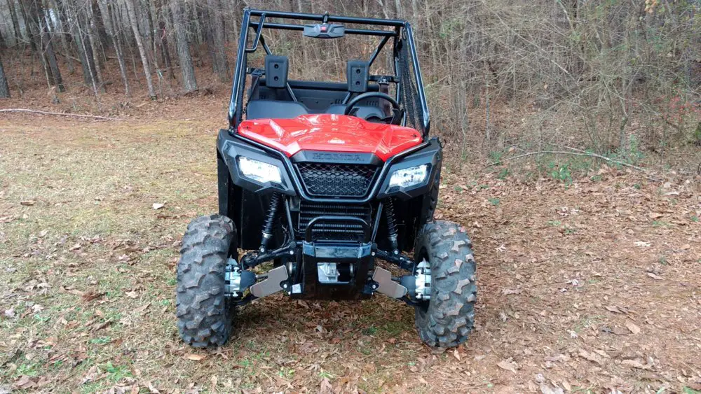

In my opinion, wider tires will rob more power than taller tires in sloppy off road conditions. I have 30" tall tires and have never needed more torque to climb anything. View media item 3348
I've never asked but often wondered how you were able to fit 30's on a P5? Even doing the frame mod wouldn't give enough clearance, did you lift it somehow?

No, in fact I had stock shocks in that photo. Sure, I have rubbed the paint off of the down tube behind the tire, but that was when it had a lot of mud on it. No Regerts! I would do it again in a second...in fact I set up a new spare tire/wheel to keep back at camp whenever I go on a group ride. I was pondering going taller next go around, but with the locker it is more than capable.
