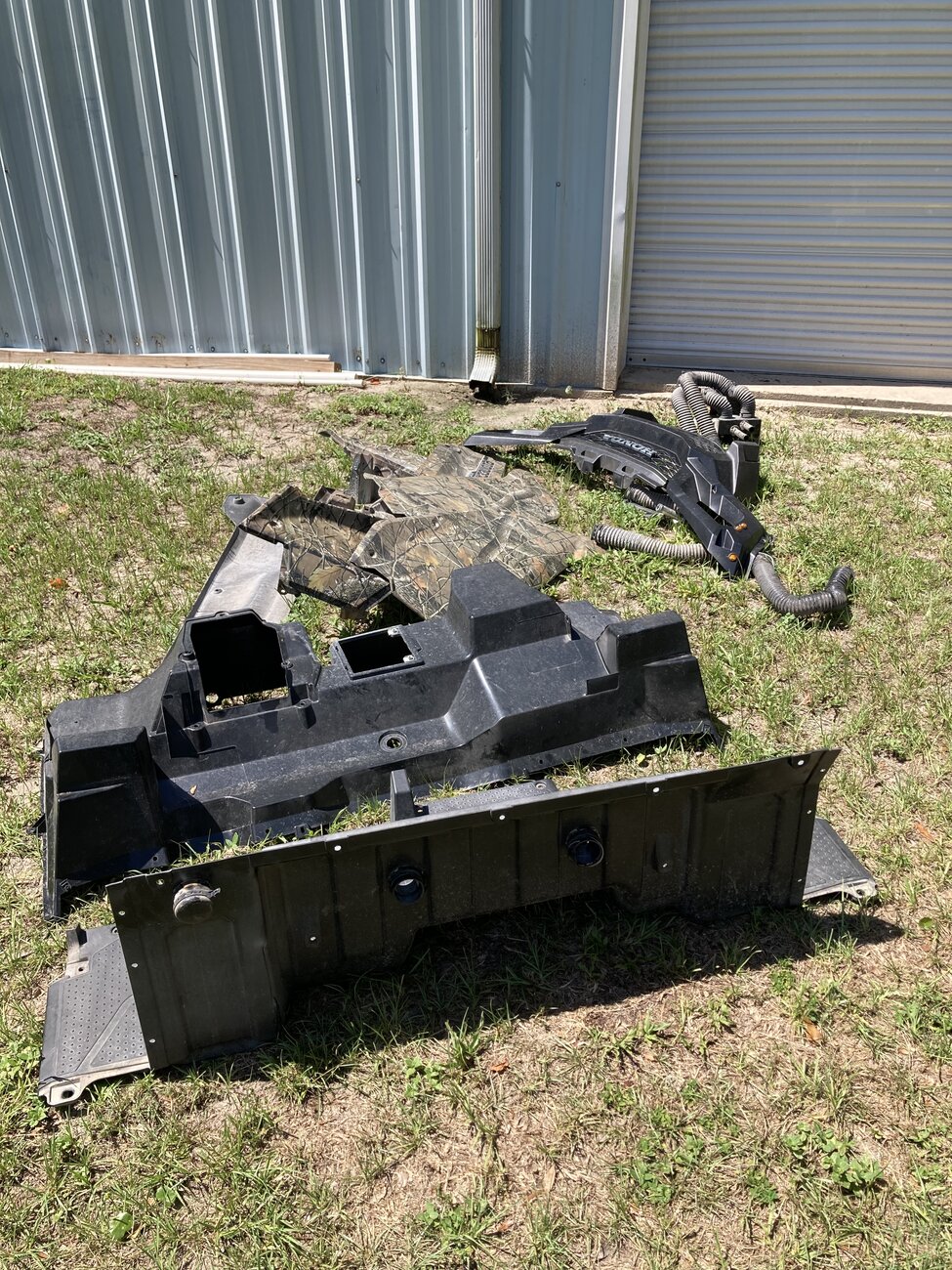

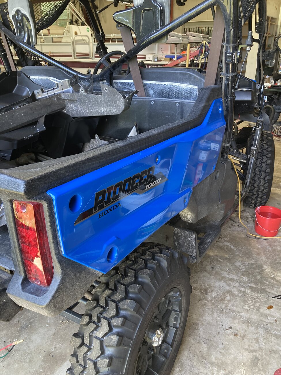

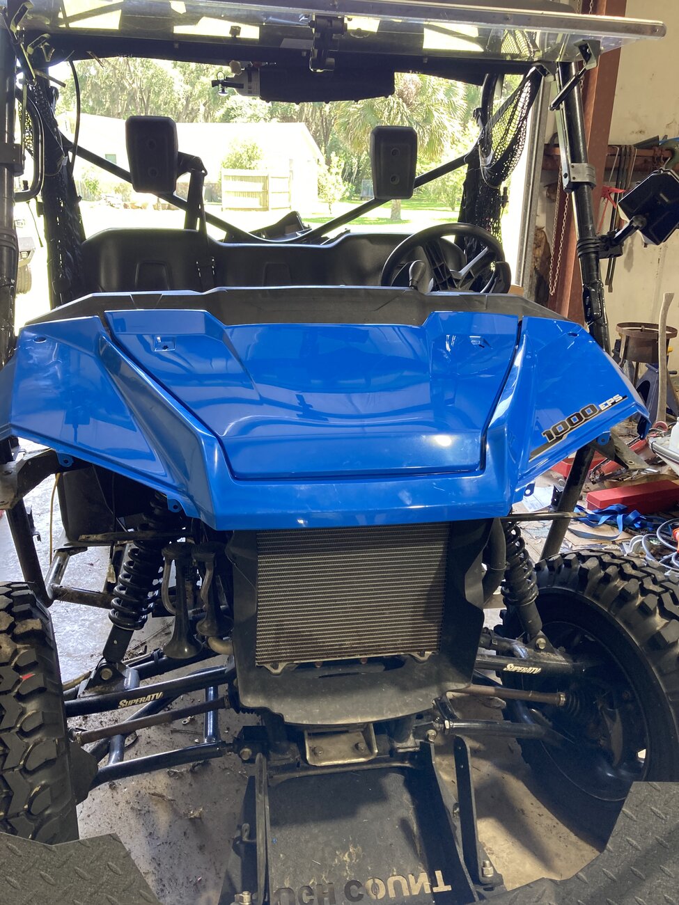

Changing colors from Phantom Camo to Proton Blue. Also replacing the firewall / floorboard that a large stick busted some time back. Will be installing stick stoppers and cleaning the wiring up too. Also added an Optima AGM battery under the seat. It's been a job, but I'm getting close to the end now.

I wanted to give anyone paying attention to this thread an important update. If you ever replace part number 2 in this diagram, whatever you do before installing the new one, BE SURE to install the headlight wiring harness first. I forgot to do it, and it was a real nightmare snaking it where it needed to be then installing the retainer clips.

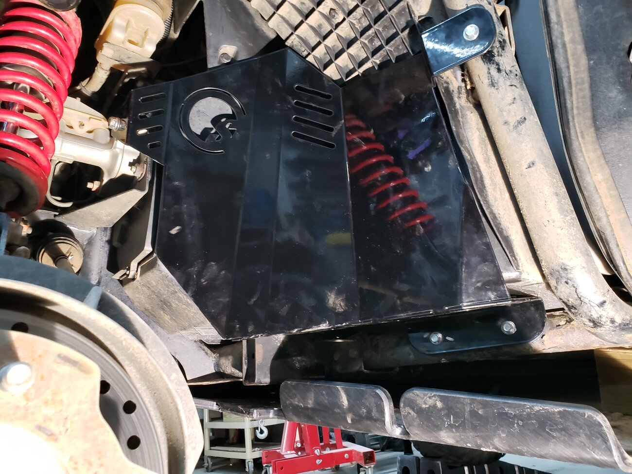

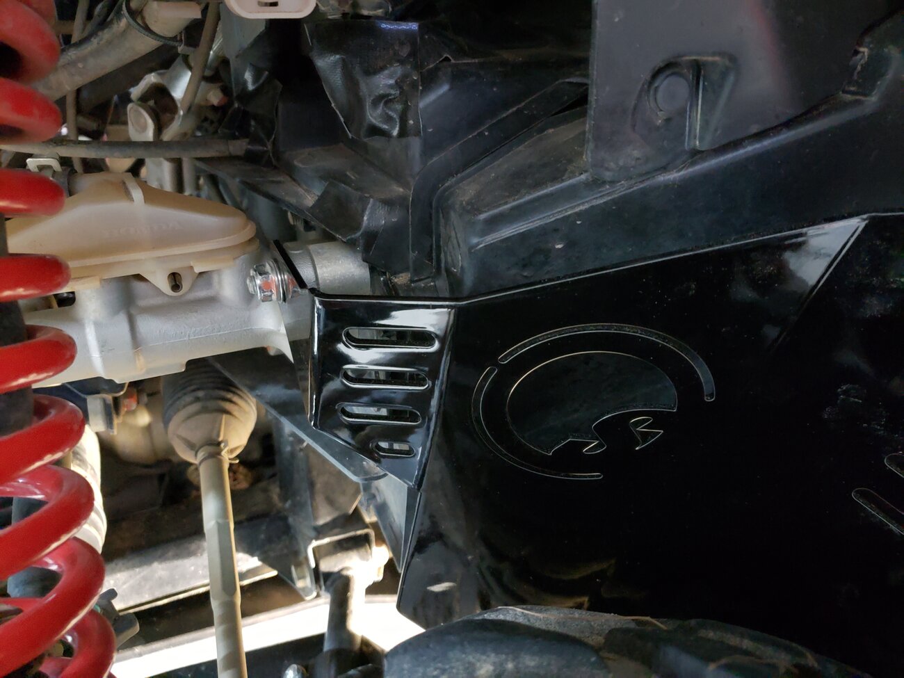

Got the Ricochet skid plates installed. Took about 30 minutes. Pretty easy install. This project turned into a much more labor intensive job than I anticipated. I bought a new winch from the company store a while back but kept the old relay and wiring in place. I went ahead and changed all of it out too, and discovered it is much nicer than the standard winch hardware. Really nice, heavy duty wireless remote. Good installation instructions. I have one question about it I'll post elsewhere for visibility's sake. I'll post up some pics later. I hope to be mostly finished today.
