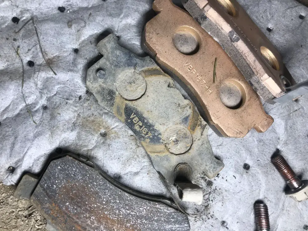

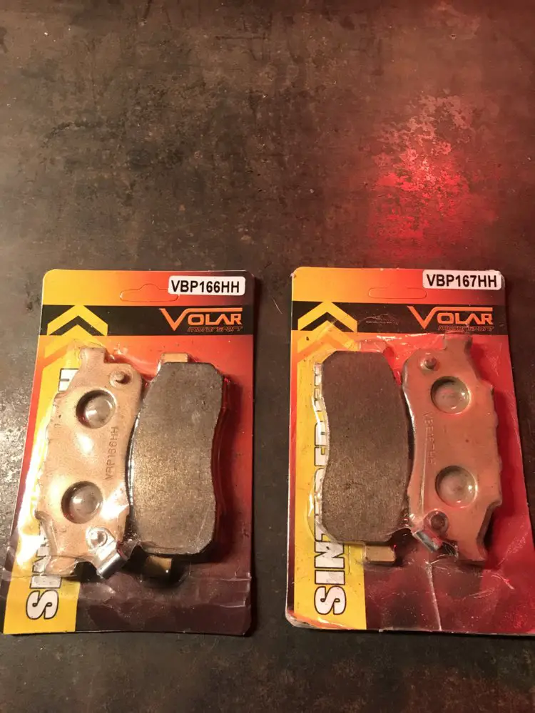

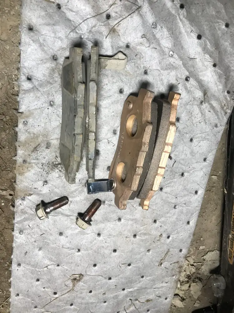

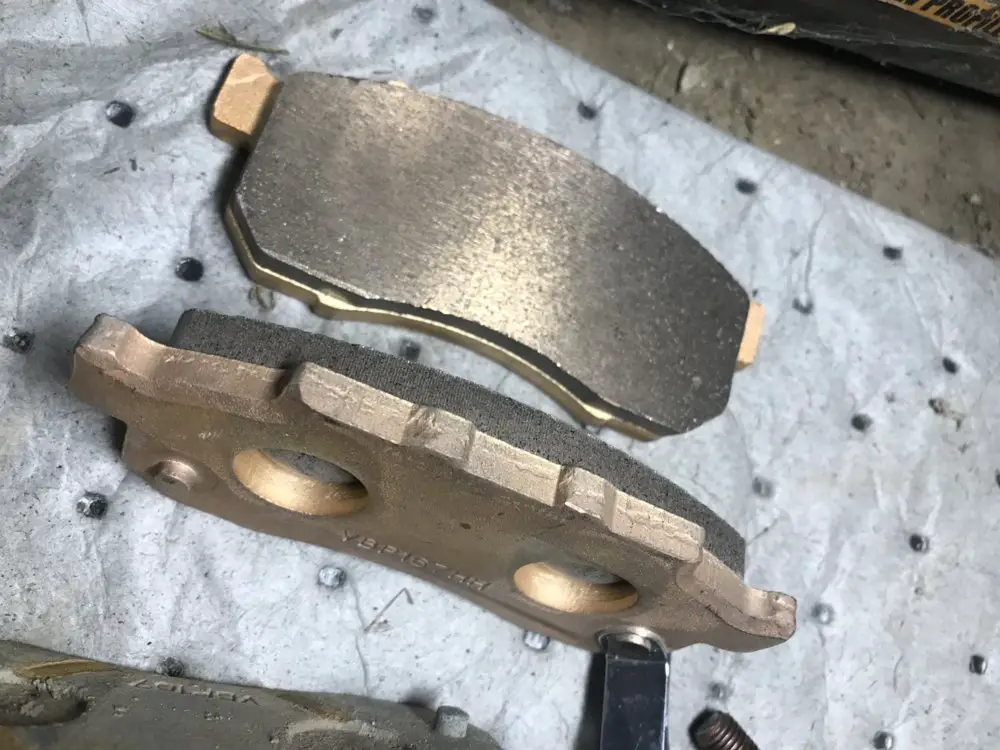

My OEM sintered pads on the front lasted right until the 600 mile mark. The second set(Volar organic $17.00 on D2MOTO)lasted until 1250 miles. I just changed to the Volar sintered( $20 or so) from D2MOTO. I’m hoping to get another 600 something on these pads. I ride mud and woods. I keep a spare set on hand for a quick change. My rear pads are still original and at about half life. I’m not concerned about rotor wear as they still look good. BTW: The fronts do wear evenly so they’re not hanging up so that’s good.;)

yep that black pad is whats on mine right now. going to toss another 70 miles on them tomorrow and itll be time to change. but also it was wearing in the new disc. so could be why they wore so quick considering utv solutions disc is very homemade design lol.

I don’t know much about the rotors as mine are still original. I’m ok changing pads every 600 miles on mine though. ;)

I also would like to mention that the stopping seems better with the sintered pads vs the organic. We’ll see how long the sintered last and how they do on the rotors. ;)

Are you replacing the stainless clips that hold the pads every time? I keep forgetting to grab them so I have to clean them up shiny. That takes me an extra twenty minutes. If they’re not clean your pads could hang up. ;)

I clean them with a wire brush...
