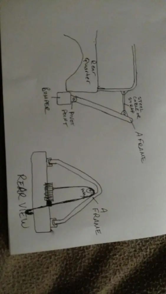

With a rear mount winch you could make a sling like a wrecker. Would have to brace the heck out of your bumper but I think I could be made to work.
Overlook the crudeness but this was kinda my idea with the A-frame. The bottom secured to bumper and swivels. Top is supported by cables or some thick sling material that I already have. Then mount a block at top of frame for winch cable to run through. When you put pressure on Derek's front bumper (sorry man I had to lol), it will pull out on top of frame and slings will support the weight. My bumper should be sticking out far enough for front tires of Don's rig (snicker) to rest on bumper. And off we go!!!
That should work too.

Did you see the pic I posted of the wrecker sling post# 2690
Yessir I did but don't understand how it works. Can you break it down so a simpleton like me can understand? Btw I wasn't ignoring the pic nor the suggestion. I always keep an open mind and welcome suggestions (even in the form of Don's criticism lol).
I know bud.... works basically like what you have drawn up . Give me a second I'll draw it up. I'm terrible at explaining things
Me either! That's why I resort to 1st grade level drawings lol

T-bar with sling attached goes up against the bumper. There are hooks welded on the end of the T-bar ,run chain around a arms on vehicle in tow ,chain hooks to T-bar, rubber belting cradles front of vehicle ,winch up, cable runs through pulley/snatch block attached to roll bar. Vehicle I'm tow raises.
Clear as mudo_O
Clear as mudo_O
Okay I kinda sorta get it. Sounds like the 2 are very similar. Next chance you get see how the sling works up against your pioneer frontend. We got plenty of time to figure something out. At least until Derek gets off work to ride again lmao. It'd be peace of mind knowing we have a de sent way to get people out of the woods. That way the wild people can get even wilder lol.
