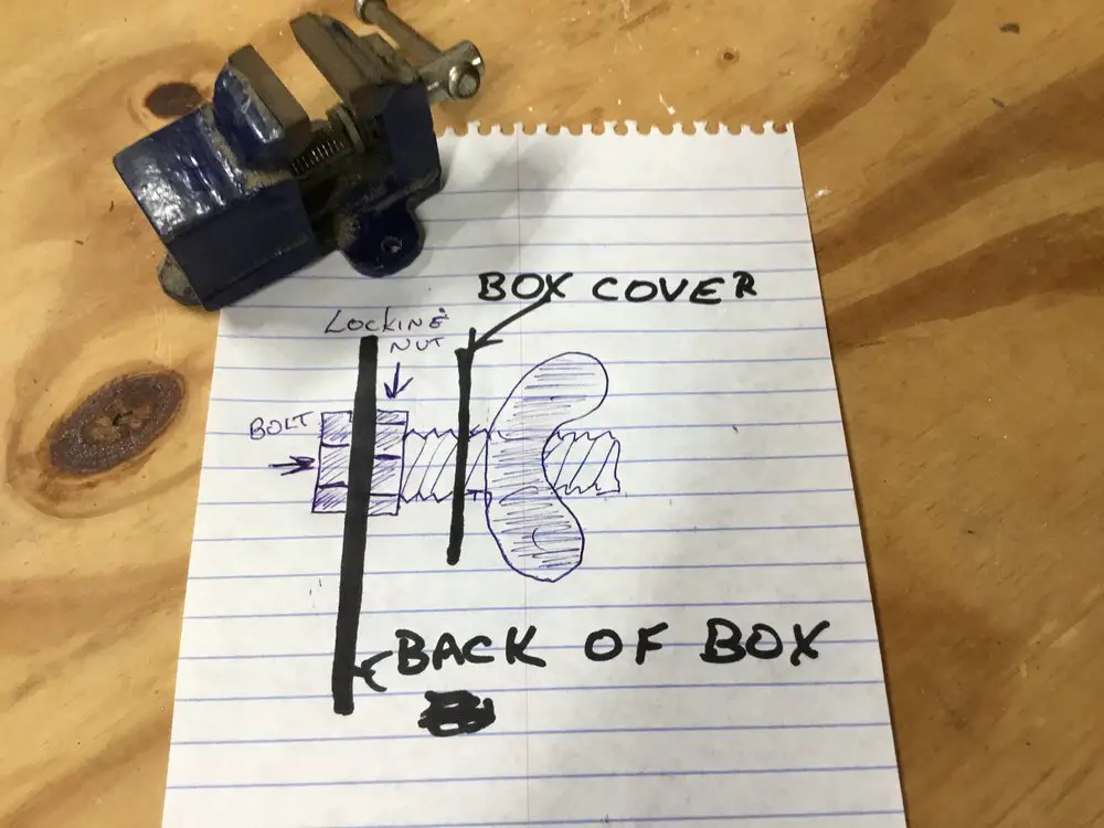

@HP5NC , like JTW, drilled a hole for heavy gauge wire into the battery box to make it easier, with silicone to seal. Short run to switched waterproof circuit breaker zip-tied to frame bar behind passenger seat makes it easy to reach switch. Got a new bolt and wing nut to replace the PITA cover bolt design. Tighten the locking nut to make a solid stud, then wing nut for easy on/off. Got circuit breaker and copper wire off a roll from auto store.

View attachment 89611 @HP5NC , like JTW, drilled a hole for heavy gauge wire into the battery box to make it easier, with silicone to seal. Short run to switched waterproof circuit breaker zip-tied to frame bar behind passenger seat makes it easy to reach switch. Got a new bolt and wing nut to replace the PITA cover bolt design. Tighten the locking nut to make a solid stud, then wing nut for easy on/off. Got circuit breaker and copper wire off a roll from auto store.
Thanks. I will certainly fix those battery box screws. And I’ll relook at the wiring for the power lead going into the box soon as I get a chance. I’ll post some pics up soon of everything. Turned out really good.
