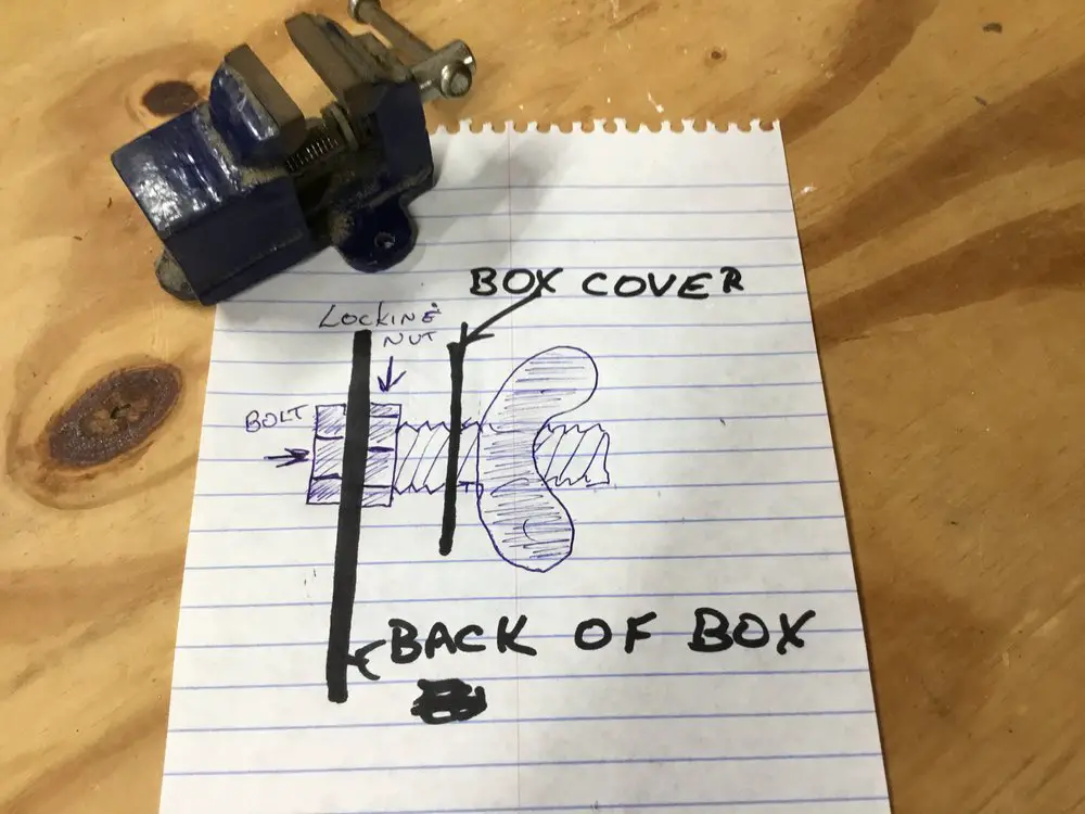

View attachment 89618 Avoid over tightening battery box cover. Thinking the Dealer over tightened mine. Top nut keeper broke loose and only spun when backing out, and could not remove. Had to remove entire battery box and fender to get behind it. Murphy's law! Modified cover bolts with new bolt and wing-nut.
Thanks for the info! Just had the same issue on my new 2017 p 500- top bolt nut just spinning . I bent the cover up over the tire , held it in place , did the work , and folded it back down. Will do a permanent fix when it’s not 95 with 100 per cent humidity!
