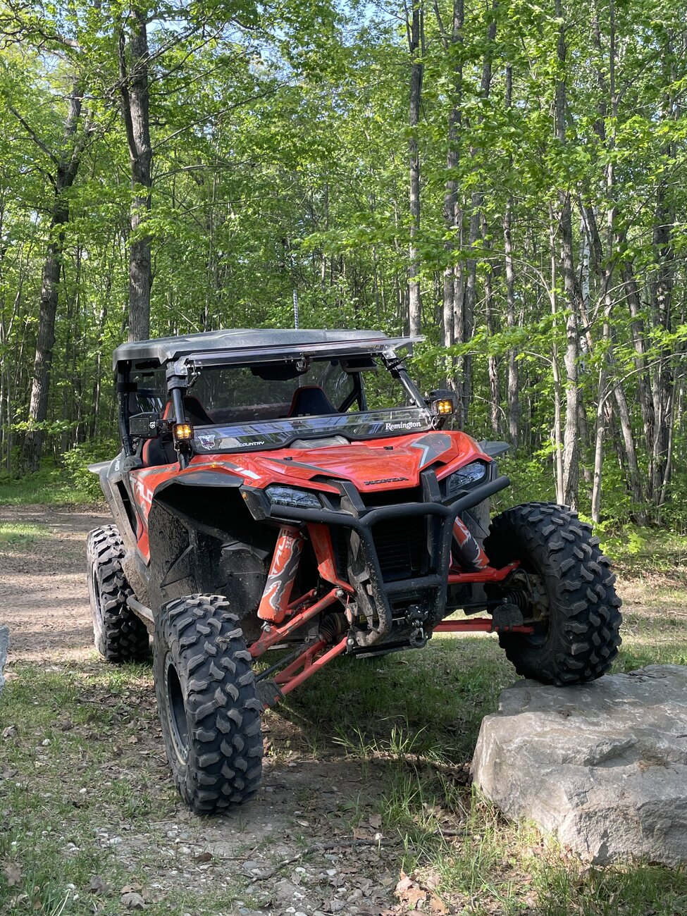

Ill start again, heres mine..
View attachment 377919View attachment 377920
