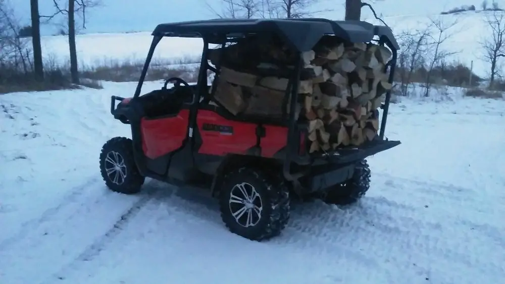

Picked mine up 10/28 first one at dealer and almost certain one of the first in WI. Hauled loads like this forward,backwards, over hills, down hills, around hills and thru the snow. Low gear manual,auto and sometimes in high manual.
So the burnt clutch issue that has happened to "several people" will happen to mine also? I just need to give it time? Frame [HASHTAG]#513[/HASHTAG], maybe the updated clutch packs started at [HASHTAG]#500[/HASHTAG]!!
No I don't think so my last 6 VIN# is 002143 made on 11/9/15 purchased on 12/22/15. So that should be the 2,143rd unit to roll off the line. I first noticed the delayed shifting mid February after 6 weeks of ownership and 170 miles approx. Nothing became really noticeable until I changed the oil on Feb 13th.
