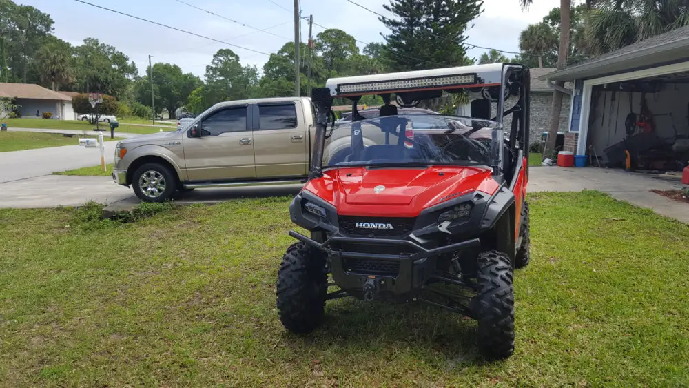

Dealer replaced my clutch baskets yesterday...Test drove my P1K today and brought it home and of course I'm on call all week so I won't be giving it a true test run until next weekend (22nd) that really sucks. It's been so long since I seen my bike it felt like I was it all over again.. like a kid in the candy store!

I just got a call my P1K is repaired, replaced the clutch packs and a Low range sub transmission part not sure if it was the gear or shifting fork, I haven't spoken directly with the tech that worked on it. Said a Honda Rep wanted to check it out before I pick it up so sounds like it will be back in the saddle soon. Must not be too terrible of a repair (labor hours) as essentially they just had all day yesterday and maybe 1/2 of today since the parts came in.

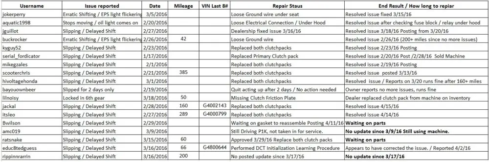

Here is the latest info from members posting, still 2 units waiting on parts one a new member whose machine has been in shop since Feb 29th. So far no "new" machines issues have been reported in a month so optimistically we will see this issue wane if all things stay the course.
P1K Issues 4 15 16

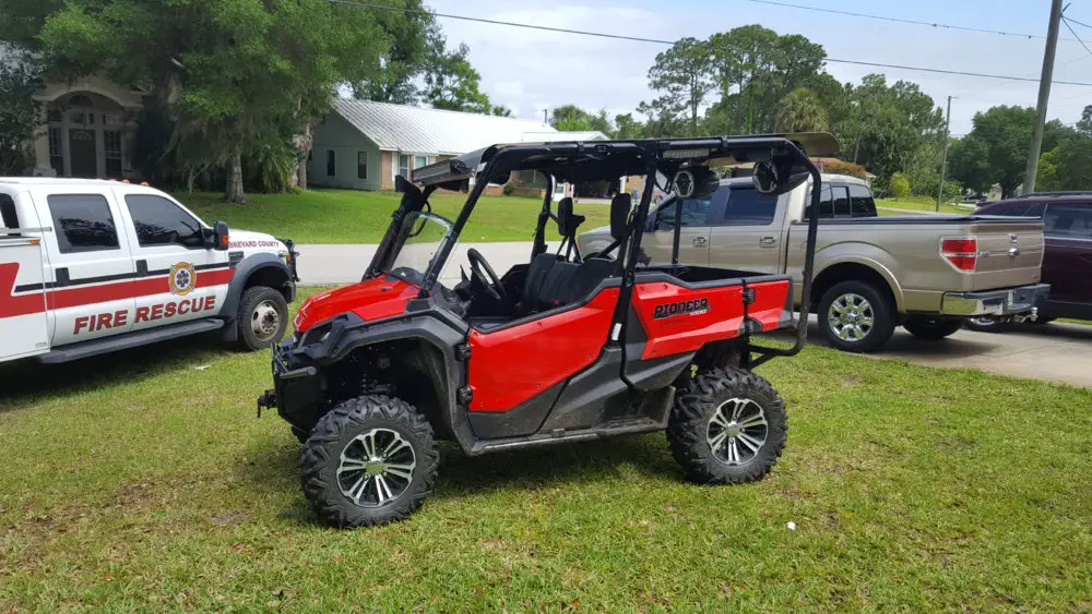

took a test drivetoday ... all seems to be fine. When I first bought this P1K I was running 67 mph on the road now it's 58 mph. Still glad to have her back!!! View attachment 13760 View attachment 13761
9 mph discrepancy, that would weigh on me pretty hard. Please let us know what happened.
Why the big mph loss?
