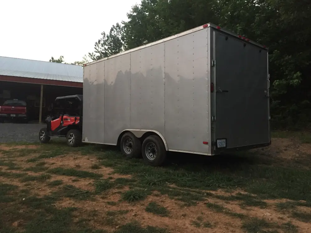

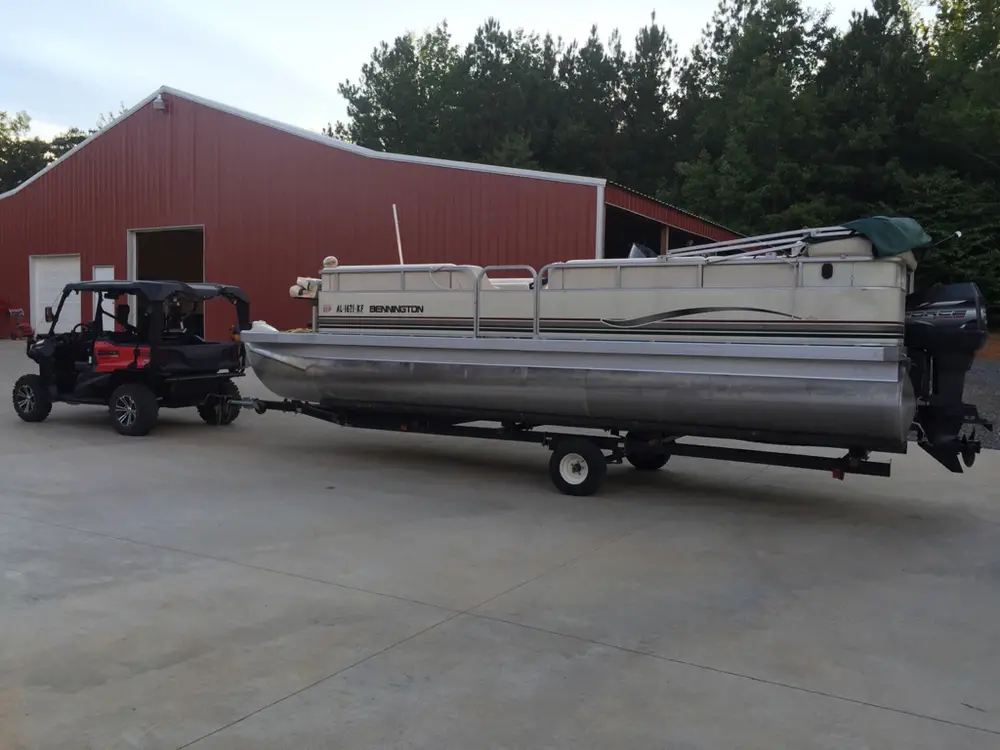

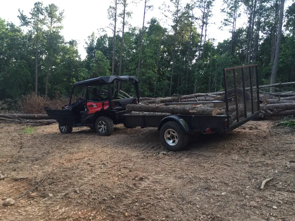

How's this for moving some weight around? These are old pics but I don't make a habit to take a pic every time I pull something.
9bfce42f55b2e6b4c6b9d68490e0d4ae
Ea9ae315c06e75a723b3d49aa7db894b
40ebef425fe80a8a9d5d0cf9e96bb792
Here's vids of where we ride.
We have a large group of pioneers that sometimes can get over a dozen. We busted tires, bent tubes, knocked skids off, broken rack and pinions, and been in mud so thick that the P1000 can't turn the 30" tires.
I'm aware that Honda has had some issues but I don't that it's a design issue after seeing us ride then pretty rough.
