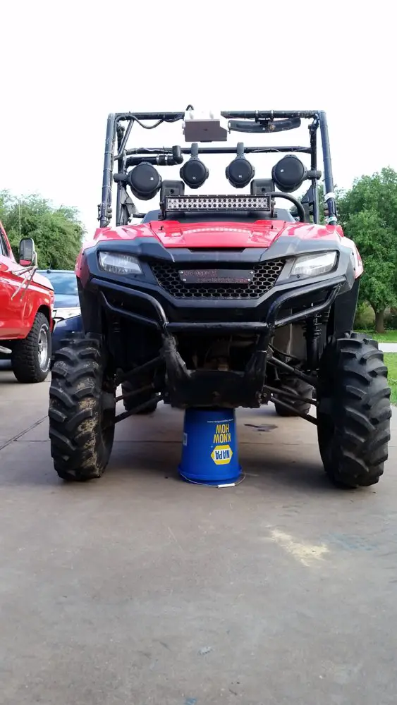

Decided to keep the rear stock shocks and turned them all the way up. It passed the 5 gallon bucket challange!

OK the rears are installed. OH MY! WHAT A HUGE DIFFERENCE IN THE RIDE. even the wife could tell the difference.5ad91c9ef88933ee61c9d9e56c281960 before
63ab5803091e89fcb9dc269cafbae665after

This is with just the shock replacement

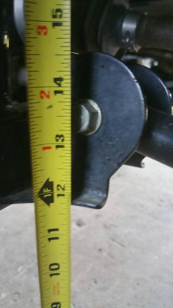

Here's what u had.9607575c202cdadfc6eaac6e41565c48before
C8a52562a76c956c8c3a8ff823e70d0bakter
Sent from my SAMSUNG-SM-N910A using Tapatalk

BTW: I did get the front shocks installed. Can-AM shocks are a direct replacement. They settled in at 2.75 inches higher than stock. I checked Toe-In before and after. Zero change. I'll try to send pics when this is complete.
