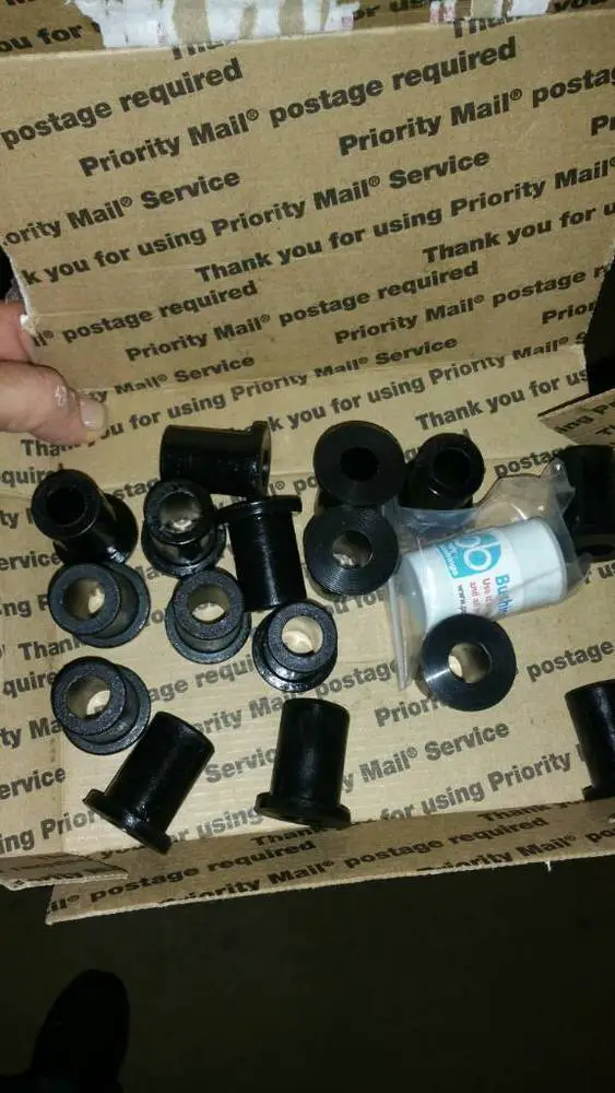

Look what can in the mail today!!!! 2d117f8fd2274af7fcba5dd9ffa401d6
Looks like I have something to do next week if I can work it in between the honeydos.

Going to use 4 per shock. If I can trim them. If not I will replace the fronts with new and have tube made to fit

I was not happy with the rubber ones that were in the shocks I bought. I actually removed the best 4 and put them in the fronts before install. It's that OCD thing.

I got mine to Tram. Let us know how you cut them. I'm pondering different ideas.

Yeah I called him back right after I placed my order and he threw in it cup of that lube

Anything special about the grease? I didn't look close but I don't think there was any in the box.
Axle Grease?
Gear Oil?
Johnson's Jerking Lotion?
Tramguage1
Tramguage1
Texan
Jul 2, 2015
7,496
30,714
Somereset, Texas
  2. 1000 6 Crew
  3. Talon X
  4. Talon R4 LV
I'll check when I get home, think it is special. Polyurethane is not compatible with all typed of lubricants. It's in an cup about the size of a 35mm film canister

Yes, it's special.
