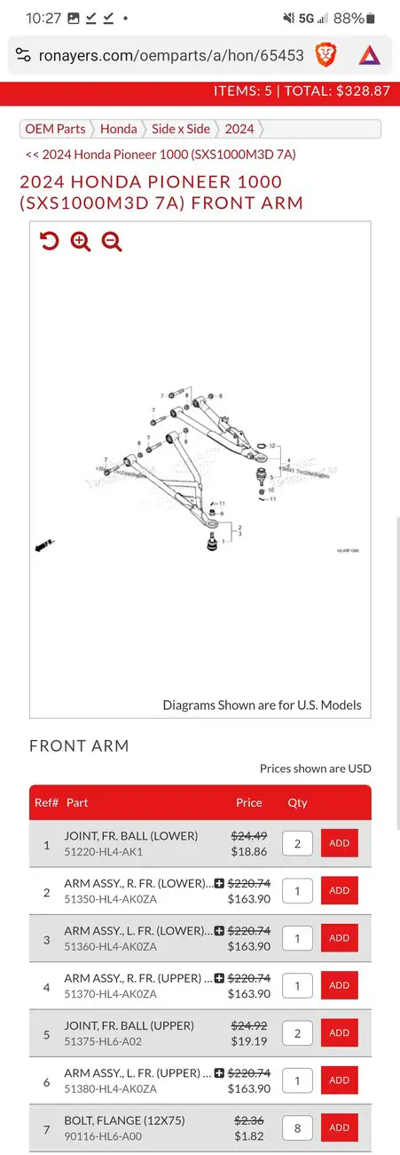

Buy new balljoints from ronayers.com
Screenshot 20240724 102750 Brave
Never had a issue with OEM balljoints while running superatv arms and 30 inch tires. I've had the arms for around 8k miles and I'm just now changing the balljoints. Had 8k on the original OEM balljoints with the original arms and never changed them. Idk anything about the atlas pro arms.

As mechanic, I NEVER reuse ball joints. They need and should be pressed out. This can cause compromisation to the ball joint itself. If you are able to save them you will be replacing them sooner rather than later. For the price Id instal new when u get the arms.
