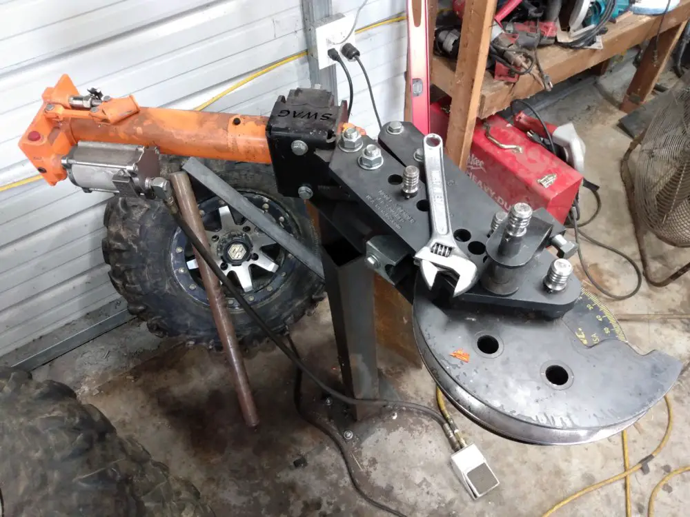

I'd like to see a pic of your tubing/pipe bender. And maybe where you got the bender.
I'll snap a pic when I get out to shop in little bit. It's a jdsquare model 3. With air/hydraulic conversion. Most benders look the same and similarly priced. Dies are what eats that wallet up lol
Model 3 is a no frills bender. Nothing fancy about it but it's built like a tank and makes beautiful bends.

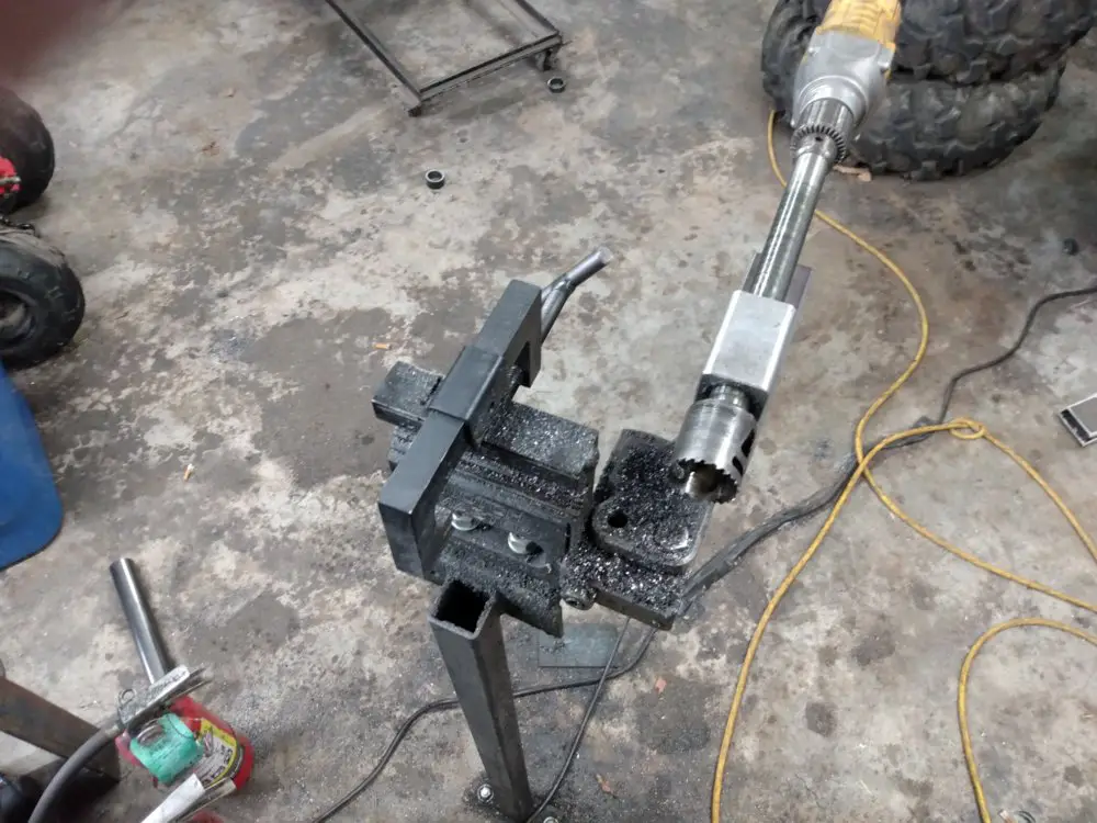

If you're looking for a notcher, I used cheap Harbor freight notcher for couple years. Very good notcher for the money. Then I stepped up to my notchmaster. Very nice and accurate notcher.

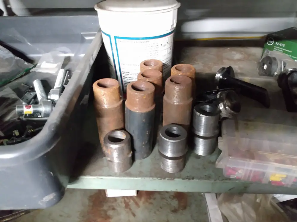

Do these fit in the stock roll cage tubing?
They were a tad looser than I like with my .095 so they'd be even looser with stock. Also they don't go into tubing as far as mine do. I leave a good inch so I can still 2 holes in tubing and plug weld. Can still do that with these but it'll have to be a real small hole lol
Thanks Delton for the pics. I have been needing a bender at work and noticed how nice your bends are.
I'm totally happy with it. There's other good ones out there as well for same money (around 295 for bender). Friggin dies are through the roof! 2" die to do Talon cage is 400 bucks!!
