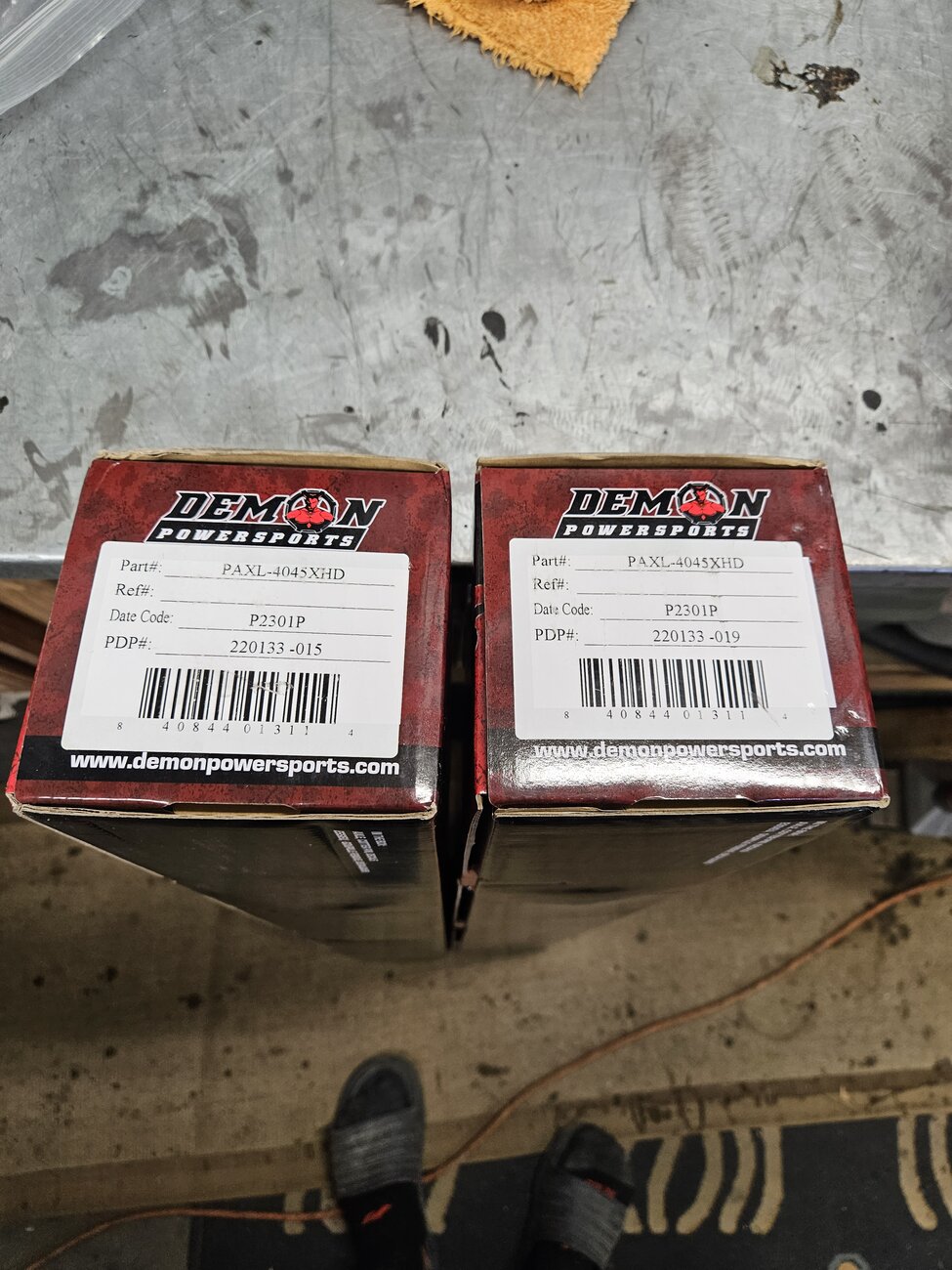

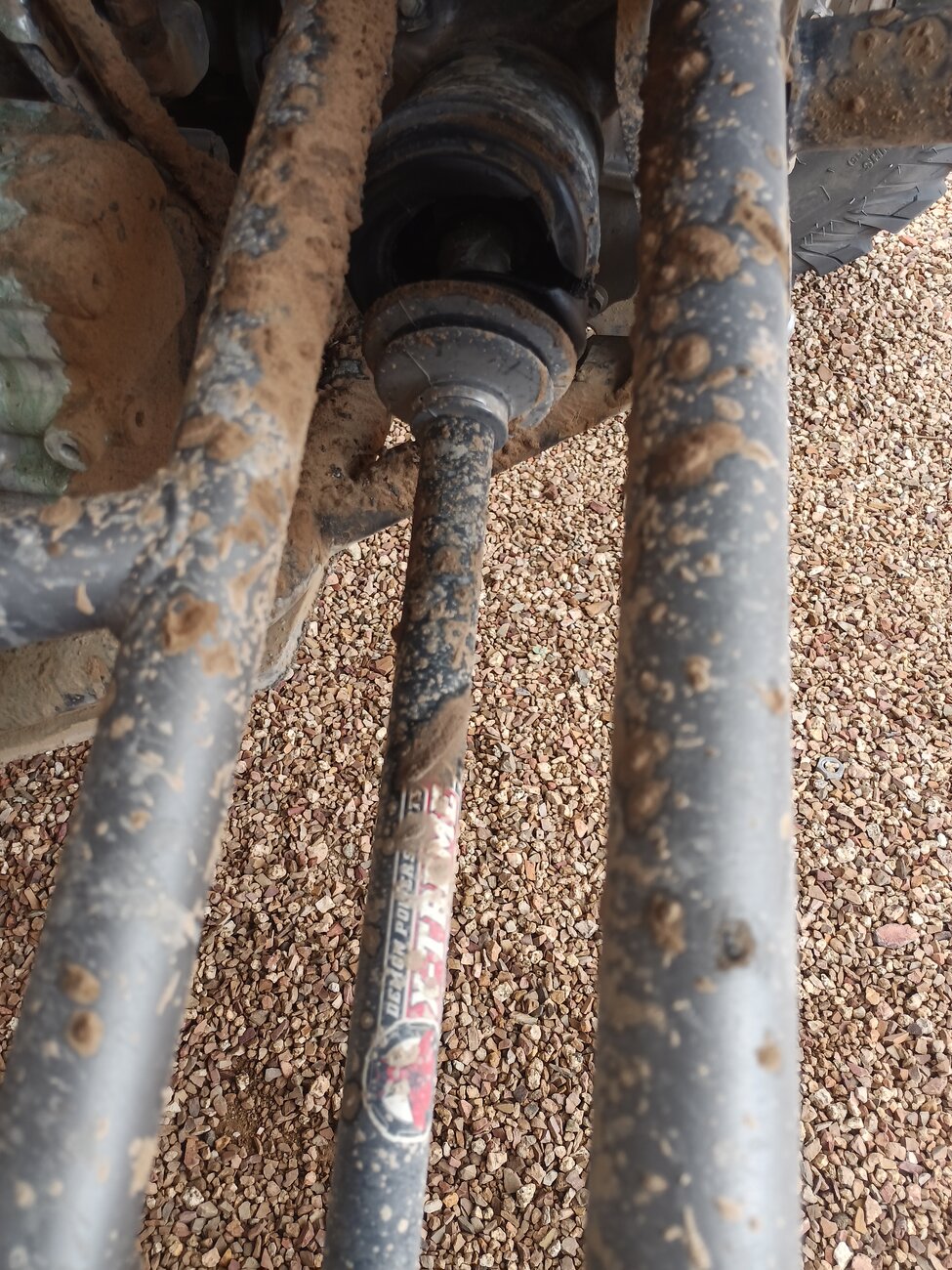

Hello Hoping to save someone time and money. I open desert race a Talon R. Been through most axles.( Monster, Open Country, 2 sets of Rhino) Stock Honda are the best with some tuning. I thought I would pay for a good set and be dome with it. Bought a SET of rear from Demon Powersports best they.(Not Cheap) Shipping took twice as long so pushed me back on up coming race. Helper installed while I was away. Got back and I received two different axle's. See there box's. They do not have any customer service that will ever help or call back. Tryed to turn in warranty card and was told run them. I had 30 days and there axles always work. An X axle will not work in am R. The X axle 015 Lasted less than 75 miles at a gas stop. Then when you start looking they are known for this and others games alot with the Can Am's. I just can not believe that two different axles they think will work. And not the cheap ones. There is no support or help at all. You can not talk to anyone they just take your money and then are never seen or heard of again. Just Please check first and just because you pay alot dose not mean they are good to work with. See Picture..
View attachment 400160 View attachment 400161
X axles won't even reach on an R, the length is too short. Other than the shaft itself, the cups are the same inner and outer for both models atleast when it comes to OEM.
