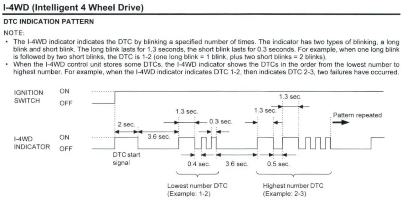

Another note..... I have been running an I4wd bypass switch since I built the car. @Hondasxs made me a custom harness that used the stock switch to accomplish the task. Car has no idea it is in 4wd and the indicator light always said 2wd. 😎
H
HondaTech
You have the luxury of that fancy Honda MCS so you don't have to "know" like the rest of us :)
True, not gonna lie sometimes i forget how to pull codes the manual way without looking in the book first. The MCS is a magical thing occasionally.
