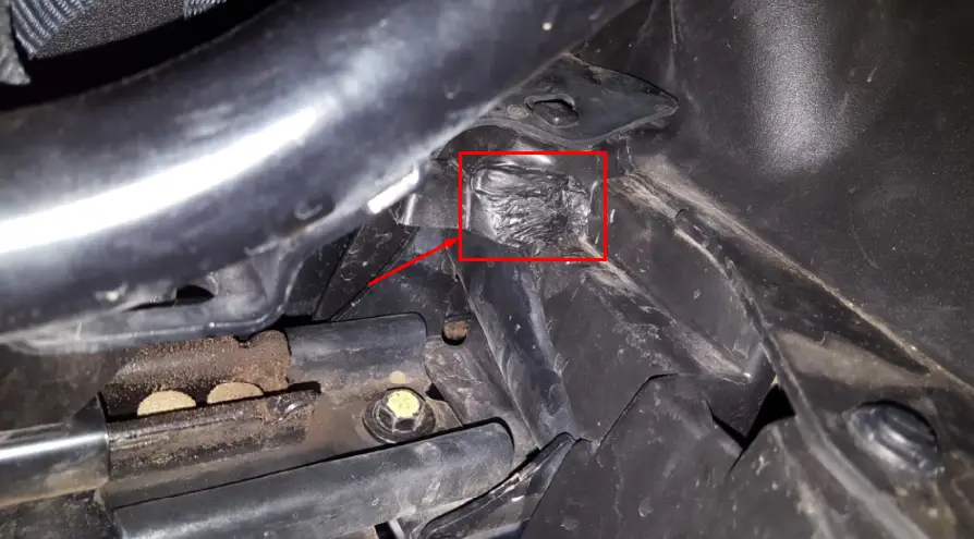

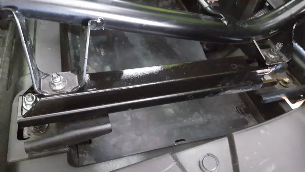

Here is the piece installed. It is the same on both sides. That's a 45 degree cut (both front and back) and there is a hole in the top to tighten the original rear nut with a socket (otherwise it is almost impossible to get to). the bolt on the front is inserted up through a hole and tack welded. The rear bolt is welded on top of the tubing and about .2 inch of filler (thickness of the bolt head) is placed there to space the rear of the seat up. This slightly changes the angle and allows the seat to go back 1.2 inches instead of 3/4 inch...
20190810 175822

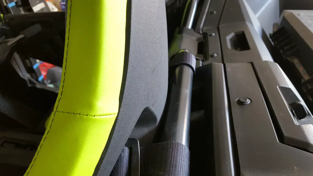

And your seat back will end up right against the harness bar...
20190810 180021
The right rail will hit the plastic so you will have to "adjust" it somehow. I used a heat gun and melted it out of the way about 1/2 inch...
That looks good. Thanks for sharing the pictures. I am going to do the same thing.
